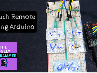

In this video, I'll show you the working of the touch remote. This is a fun project. I wished I could control the television using a touch remote. So I decoded my TV remote and used aluminum foil as touch pads. Since many suggested adding an explanation, I had added a voice-over. Hope you like this video. Thank you all!

For this circuit, I had used a thin foil of aluminum as a touchpad which can be used as a remote button. For this remote circuit, I had used five touchpads
  • a volume up,
  • a channel up,
  • a volume down,
  • a channel down
  • and an on/off switch
and IR LED is used to transmit the data to the television and LED to indicate the presence of data transmission and some jumper cables which connect the Arduino and the breadboard.
Now let me show you the buttons which have been made, I had folded the aluminum foil in the shape of a rectangle and each button is connected using wire, each pad is connected to Arduino's input and whenever I press each button the data corresponding to that switch will be sent through the IR transmitter.
As you can see the LED blinks at the delay rate of 40ms and whenever we pressed the button the LED blinks in accordance with the hex value which I have implemented from the remote. Alright, let me show you the remote circuit. Here, for this project, I had used a sony remote. I used the decoding algorithm to map the buttons volume up, volume down, channel up, channel down, and on a touchpad and I had implemented the code in the Arduino.
