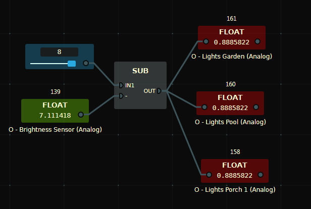

Step 2: Connect I/O Solution

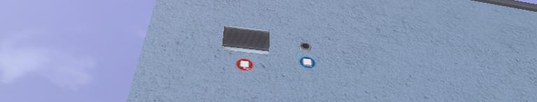

Step 3: Description of Function Used: Bit 139 (Type Float): Brightness Sensor (Analog)
Float is a data type in which we can store value in this range: -3,4 × 1038 to 3,4 × 1038. The Bit 139 is standardized bit which gets the analog value (in the range 0 ~ 8) from the Brightness Sensor. When the luminance is 100% the value is 8 & when the luminance is 0% the value drop done to 0. So the value in this Bit 139 varies in proportion to luminance of day light

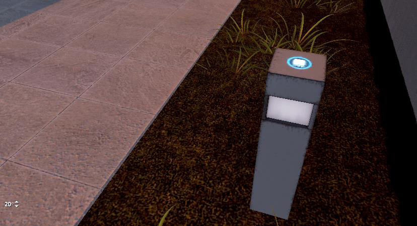

Step 4: Decription of Bits Used: BIT 161: Light Garden (Analog)
It’s the standardized floating bit 161 for Lights Garden (Analog). The value in this bit decides the luminance from this light. If the value is 0, the lights are OFF with no luminance. If the value is 8 the luminance is 100%.

Step 8: Explanation of Solutions
In the Connect I/O Logic, BIT 139 respond to Luminance of the day light. We need to subtract this from the Constant 8 because we need to invert its value & give it to Float Output of Lights Garden, Pool & Porche
Example:
= 8 – 7.111(88 % Day Luminance)
= 0.888 (11% Luminance of Light)
It means at 88% Day light luminance we have 11% garden, Pool & Porche Light luminance
This cycle can be repeat again & again.
