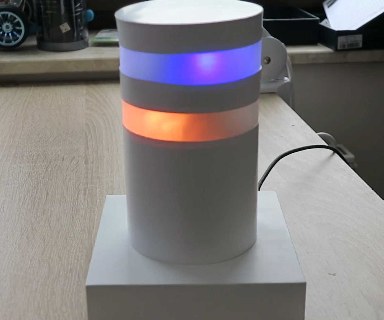

When you press the first button on ESP2, the diode on both arduino and the switch on the website will change to the opposite one
When on ESP2 we press second button component color on the website and RGB LEDs will change to random.
The switch on the website changes the states of the individual LEDs on both ESP to the state corresponding to the switch. When the website changes color – the color of the RGB LED will change to the selected one

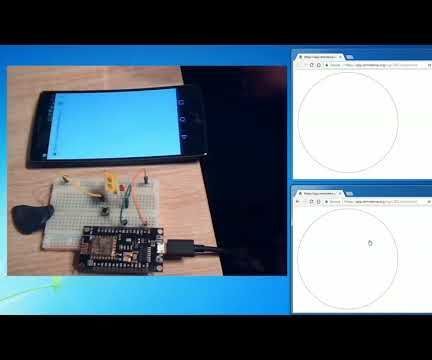

If we open the page also in the second tab and on one of them we change the color or state of the diode - it will also change on the second page.
