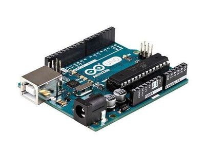

  • Arduino UNO (or any other board)

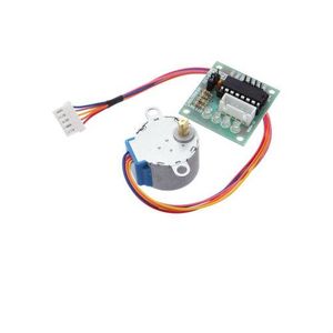

  • 2X Stepper motor 28byj-48 & stepper motor driver board

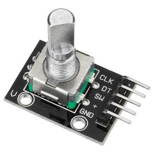

  • Rotary Encoder Sensor

  • Connect Arduino pin [5V] to Driver Board1 pin [VCC]
  • Connect Arduino pin [GND] to Driver Board1 1pin [GND]
  • Connect Arduino digital pin [6] to Driver Board1 pin [IN1]
  • Connect Arduino digital pin [7] to Driver Board1 pin [IN2]
  • Connect Arduino digital pin [8] to Driver Board1 pin [IN3]
  • Connect Arduino digital pin [9] to Driver Board1 pin [IN4]
  • Connect Arduino pin [5V] to Driver Board2 pin [VCC]
  • Connect Arduino pin [GND] to Driver Board2 1pin [GND]
  • Connect Arduino digital pin [10] to Driver Board2 pin [IN1]
  • Connect Arduino digital pin [11] to Driver Board2 pin [IN2]
  • Connect Arduino digital pin [12] to Driver Board2 pin [IN3]
  • Connect Arduino digital pin [13] to Driver Board2 pin [IN4]
Connecting Encoder module:
  • Connect Encoder module pin [CLK] to Arduino digital pin [2]
  • Connect Encoder module pin [DT] to Arduino digital pin [3]
  • Connect Encoder module pin [SW] to Arduino digital pin [4]

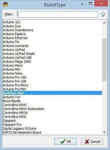

Step 3: Start Visuino, and Select the Arduino UNO Board Type
Start Visuino as shown in the first picture Click on the "Tools" button on the Arduino component (Picture 1) in Visuino When the dialog appears, select "Arduino UNO" as shown on Picture 2

  • Connect Arduino digital pin [2] to "RotaryEncoderSensor1" pin [Direction]
  • Connect Arduino digital pin [3] to "RotaryEncoderSensor1" pin [Clock]
  • Connect "RotaryEncoderSensor1" pin [Out] to "MultiplyByValue1" pin [In]

  • Connect "Stepper1" pin [0] to Arduino digital pin [6]
  • Connect "Stepper1" pin [1] to Arduino digital pin [7]
  • Connect "Stepper1" pin [2] to Arduino digital pin [8]
  • Connect "Stepper1" pin [3] to Arduino digital pin [9]
  • Connect "Stepper2" pin [0] to Arduino digital pin [10]
  • Connect "Stepper2" pin [1] to Arduino digital pin [11]
  • Connect "Stepper2" pin [2] to Arduino digital pin [12]
  • Connect "Stepper2" pin [3] to Arduino digital pin [13]

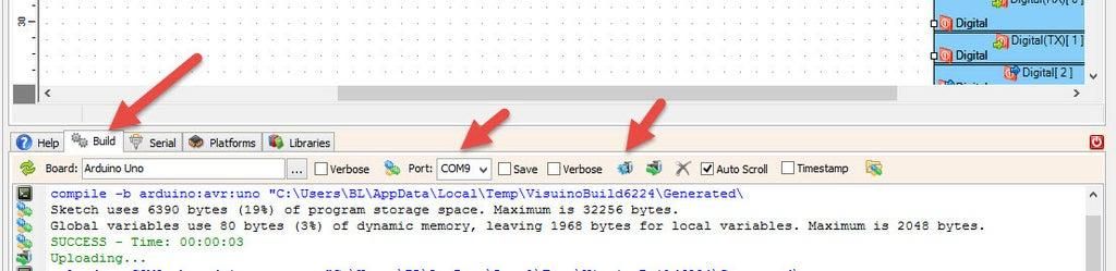

Step 7: Generate, Compile, and Upload the Arduino Code
In Visuino, at the bottom click on the "Build" Tab, make sure the correct port is selected, then click on the "Compile/Build and Upload" button.
