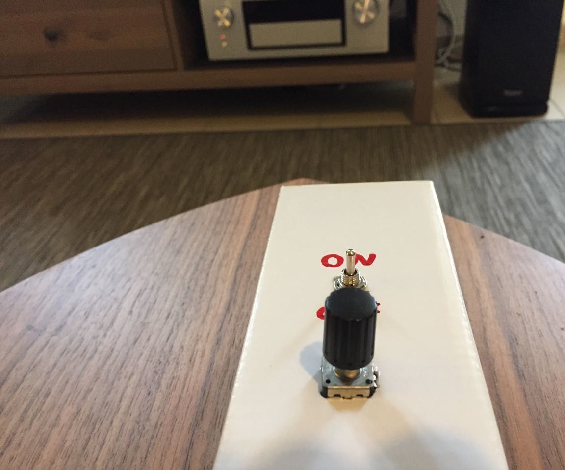

- also use a card box as a case for the project
