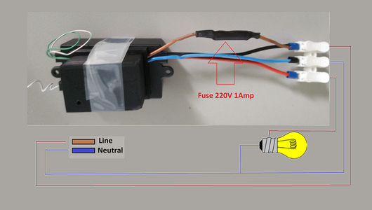

Step 5: Transformer 12V and Channel Relays
A new setup of 12V Transformer plus the channel relay should be 'added' into each led light connection (Except lights 8&9) in order to get commands from the Arduino Antenna.
The story behinds the photos is the following .
  1. The sun relay is been triggered when it's getting dark and its powering each light with 220V power. At this state all 15 lights are turned ON, also ESP8266 is turned ON, is been connected through Wifi and checking the conditions in order to execute commands.
  2. On each single garden light, the transformer is powering with 12Volts DC the Channel Relay which waits the command from the Arduino. At this state the light is turned ON.
  3. As photos present, the power line (220V) comes at the channel Relay in which is connected to NC and Com. When the antenna will trigger the channel, the relay will be switched on , turning the light OFF.
  4. If the transformer or the RF Channel fail, the lights will remain ON during the night, providing the necessity of keeping the lights on during the night.
