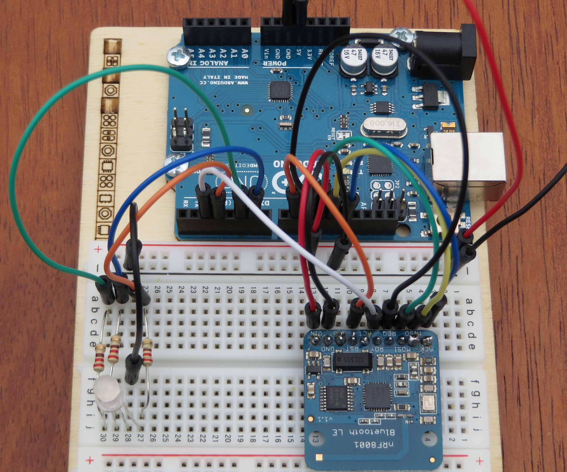

Use a power transistor such as a N-Channel MOSFET between the Arduino and the light strip.
The transistor should be rated to be greater than or equal to the maximum current that your lights will draw. To determine the maximum current draw multiply 20 milliAmperes times the number of LED's on the strip. For example, a strip with 300 LEDs would draw up to 6 amperes.
With the black gate facing you, connect the left pin to the Arduino, the middle pin to the light strip and the right pin to ground. Connect the Red, Green, and Blue channels to Arduino pins 3, 5, and 6 respectively.
Connect the light strips 12V anode directly to a 12V power supply and connect the power supplies negative terminal to the common ground.
Further information on working with light strips is available here.
Step 2: Connect the Bluetooth Low Energy Board
Connect the nRF8001 Bluetooth LE breakout board to your breadboard. Connect the BLE pins to the Arduino as follows:
- SCK - 13
- MISO - 12
- MOSI - 11
- REQ - 10
- RST - 9
- RDY - 2
Further information on the using the nRF8001 BLE board is available here.
