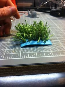

A Stroke Sensor is a device that responds to your touch, with the nice soft feeling of fabric and yarn. You can use it to add plush controls for your Mod that can be embedded in your clothing or even stuffed animals.
This is adapted from Hannah Perner-Wilson and Mika Satomi's work at Kobakant. The sensor allows individuals to rub, stroke, squeeze, brush, and even pat in order to distribute corresponding vibrations to your Mod. Swivel your fingers through this furry sensing device and witness the variation in vibration intensity transmitted to your personal massager!

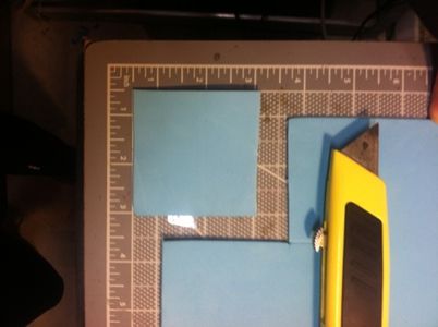

1) Cut Foam Sheet
Begin fabricating your sensor by taking a sheet of foam sheet, cutting it to the desired size that you want your sensing device to be.

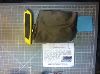

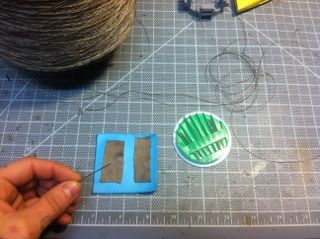

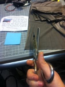

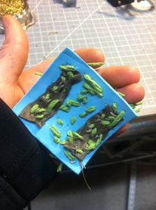

Cut two pieces of conductive fabric. Then take both pieces of stretch conductive fabric, stacking them atop of one another to allow for equally cut strips to be made of the two materials. Make sure to cut their size to fit within your foam's shape. The strips of conductive fabric will go on opposing sides of the foam surface area you previously cut.

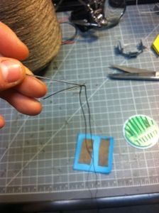

3) Threading Needle
To thread your needle, begin by taking your conductive thread and sticking it through the eye of your needle. Keep in mind that we will be performing a double stitching method. This stitching method involves stitching two strands of thread at a time, allowing us to conserve our efforts.
Make sure to continue pulling the thread through your needle so that it's long enough to stitch the entire side of one of the conductive fabric pieces to the cut foam sheet.
4) Sewing Conductive Thread

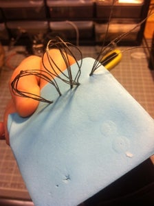

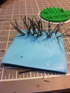

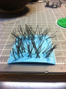

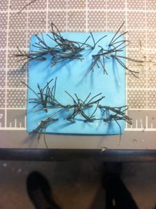

Begin stitching your conductive thread along your first conductive fabric piece. Make sure to stitch completely across the foam sheet and conductive fabric, leaving about an inch and a half of thread slack on the front side of the sensor (opposite side of conductive fabric). It should look like hair follicles sticking out!
Continue to stitch across the foam in this fashion until the total surface area of the conductive fabric is fully fastened to your foam. Repeat this step for the second strip of conductive fabric that will be on the other side of your sensor. Make sure to cut the loops that were made when sewing to make individual thread strands.

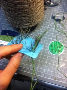

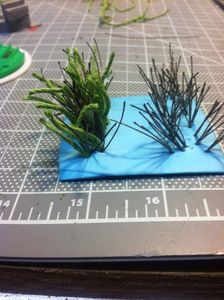

5) Sewing Resistive Thread

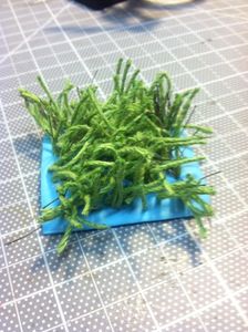

After sewing your conductive fabric with conductive thread, you will then take your resistive thread (we used yarn!) and sew the negative spaces of the foam sheet. Make sure that the resistive thread and conductive thread are close in proximity, allowing the yarn to occupy the rest of the foam sensor space.

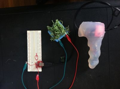

1) Alligator Clips
Attach both alligator clips to each side of your sensing device. Make sure that the clips make contact with conductive fabric. Set this piece to the side -- you will be using it again very soon!
2) Setting Up Breadboard
Take your breakout board and mount to the top of your breadboard. Next, you will take one of your alligator clips end, and clip in one of your wires securely. You will then take that attached wire and insert it into the breadboard, corresponding to the breakout board’s VCC. Next, take your second alligator clip and attach both your remaining wire and resistor. You will then insert your resistor into GND and your wire into D+.

Now that you have set your Mod up to detect the stroke sensor device, all there is left to do is plug in the USB to your breakout board socket and stroke away!
