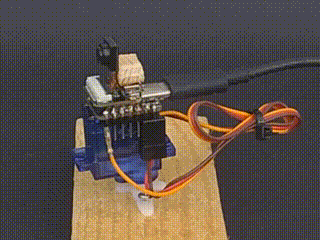

Step 1: Hardware: Connect the Servo
Connect the servo as seen in the wiring diagram: 5V (red), GND (brown) and Data to GPIO 44 (D7). You can also connect servo's 5V and GND to another 5V power supply, but don‘t forget to connect the GND to the ESP32.

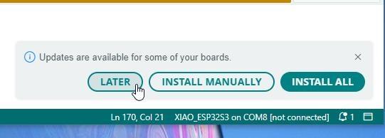

2. Board manager: ESP32, Version 2.x. Version 3 is producing error messages with the servo libraries.
Resist when your Arduino IDE prompts you to update the board information!
