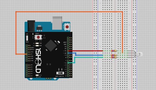

Step 2: Wiring and Setup
- Place your RGB LED in the Breadboard
- Connect the Anode (the longest pin) to the 5V pin
- Connect the other three pins to a 270 ohm resistor as shown in the schematic.
- Connect the Resistors to the 1sheeld as stated below and in the schematic.
Green ===> pin 6
Blue ===> pin 10
Red ===> pin 11

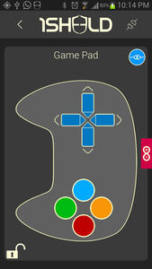

Step 4: Turn on the Lights !
In order to do that we need to do the following
- Make sure the 1sheeld is in operating mode
- Open your 1sheeld app and connect your phone to your 1sheeld board
(check 1sheeld tutorial here if you haven't already) - Select the Gamepad shield from the shield list
- Now for the final act hold down 1 of the three colored circles (Red/Green/Blue) and press Up or Down to increase/decrease that colors intensity.
- Have fun experimenting and mixing colors.
