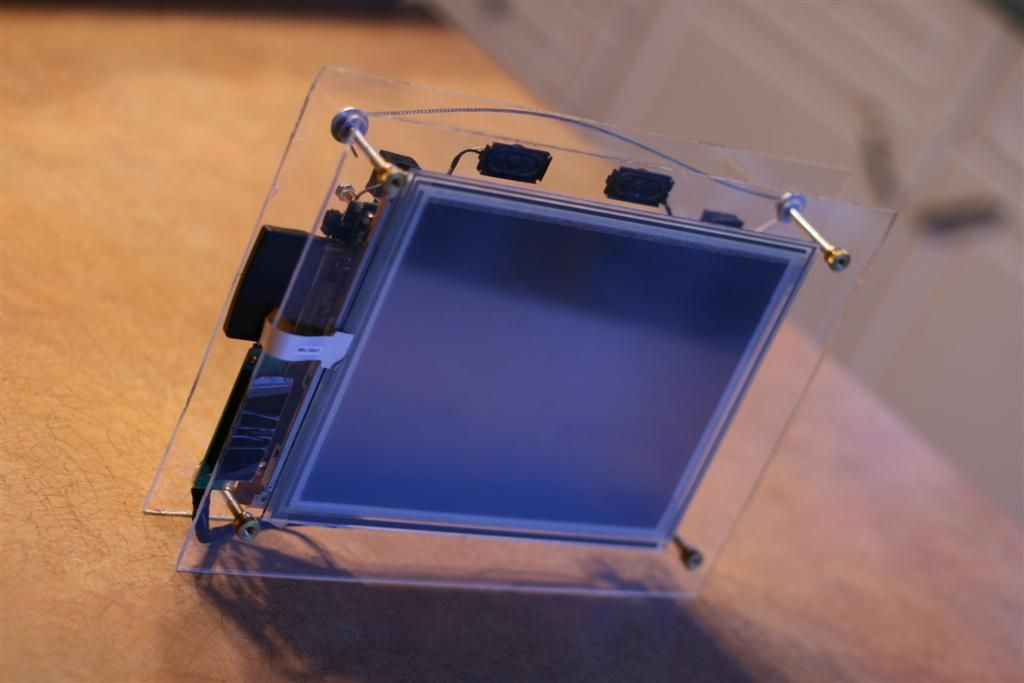

Optional:
I use my Digital Picture Frame (https://www.instructables.com/id/Digital-Picture-Frame/) as a console to control the entire system.
Optional:
