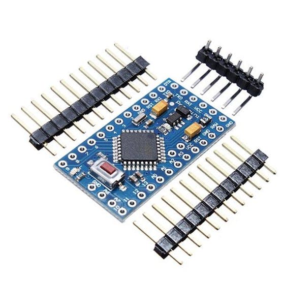

The APC220 module control system with a smartphone and an application, using a serial USB adapter, involves the use of a receiver that can be an Arduino Mini Pro. This Arduino Mini Pro acts as a receiver for the signals sent from the smartphone through of the APC220 modules.
The Arduino Mini Pro acts as the control center that receives instructions transmitted from the smartphone app via the APC220 modules connected through the USB serial adapter. The Arduino Mini Pro can interpret these signals and execute specific commands to turn on or off lights, activate motors, or operate other devices connected to it.

Arduino mini pro

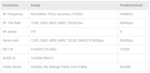

Specification
  • Working frequency: 420 MHz to 450 MHz
  • Power: 3.5-5.5V
  • Current: <25-35mA
  • Working temperature: -20°C~+70°C
  • Range: 1200m line of sight (1200bps)
  • Interface: UART/TTL
  • Baud rate: 1200-19200 bps
  • Baud rate (air): 1200-19200 bps
  • Receive buffer: 256 bytes
  • Size: 37mm × 17mm × 6.6mm
  • Weight: 30g

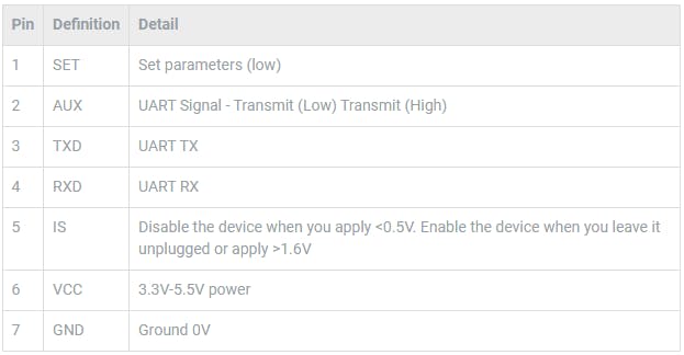

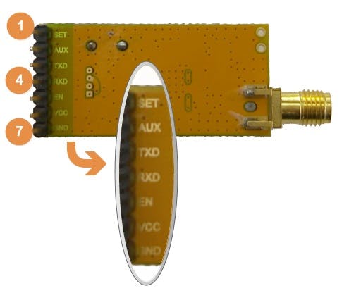

Pin Out

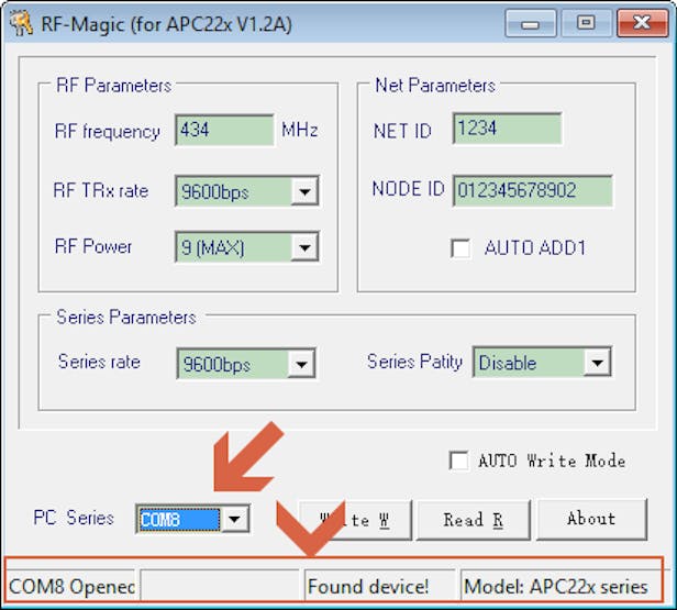

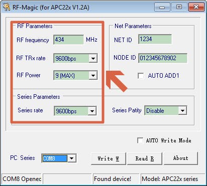

Run APC22X_V12A.exe (RF-Magic) as administrator if your system is not Windows XP.
NOTE : the software will recognize the APC220 module and COMX serial port automatically once we open it. Check in Device Manager to verify the correct COM port .

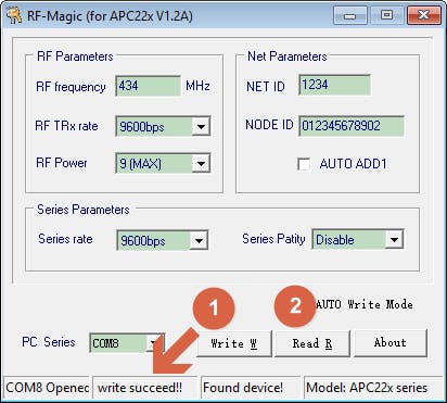

Configure RF-magic as in the red square frame below (default configuration), and click Write W to write your configuration, then click Read R to read the parameters you have set.
Setting
Write and read settings

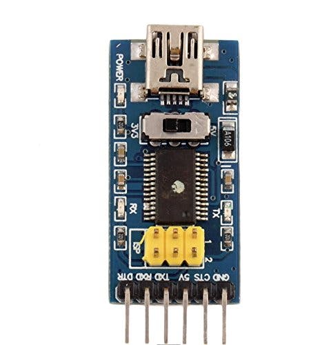

Usb serial adapter
Description
FTDI Basic Program Downloader USB to TTL FT232RL 3.3V 5V DTR
This is a basic breakout board for the FTDI FT232RL USB to Serial IC. The pinout of this board matches the FTDI cable to work with official Arduino boards and cloned 5V Arduino boards. It can also be used for general serial applications. The main difference with this board is that it brings out the DTR pin instead of the RTS pin on the FTDI cable. The DTR pin allows an Arduino target to automatically reset when a new Sketch is downloaded. This is a really nice feature and allows a sketch to be downloaded without having to press the reset button. This board will automatically reset any Arduino board that has the reset pin on a 6 pin connector.
This board has TX and RX LEDs which make it a bit nicer to use over the FTDI cable. You can actually see the serial traffic on the LEDs to check if the board is working.
This board was designed to decrease the cost of Arduino development and increase ease of use (the auto reset feature is great!). Our Arduino Pro boards and LilyPads use this type of connector.
One of the nice features of this board is a jumper on the back of the board that allows the board to be configured to either 3.3V or 5V (both power output and I/O level). This board ships at 5V by default, but you can cut off the default trace and add a solder jumper if you need to switch to 3.3V.

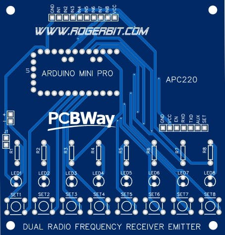

A Jumper

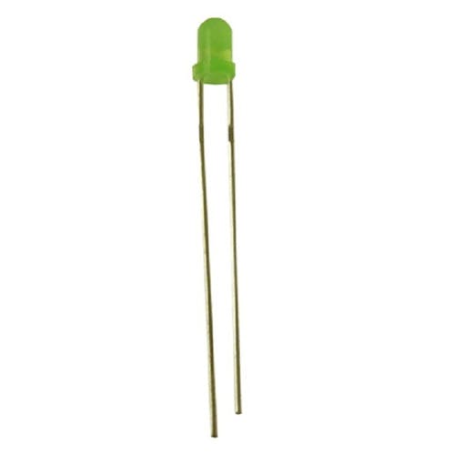

8 3mm LEDs
8 1KOhm resistors
Female pins

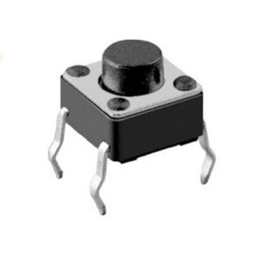

8 Push Buttons

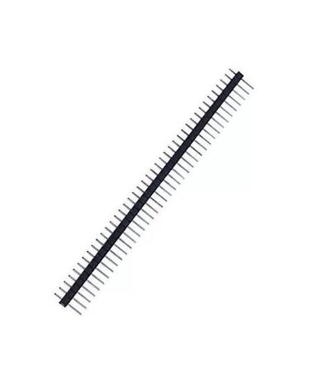

Male pins

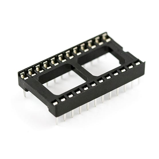

A socket for arduino mini pro
PCB
Download the free gerber file from here and send it to manufacture optionally–> https://www.pcbway.com/project/shareproject/Dual_Synchronized_Radio_Frequency_Control_for_Motor_Lights_and_more.html

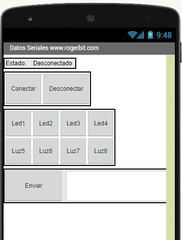

App inventor
Download app and source file –> serial_app_ardu_radio
