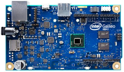

1- Intel Galileo Gen 2

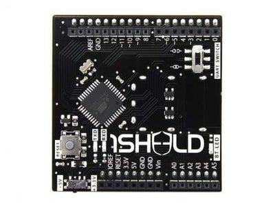

2- 1Sheeld
3- 6 DOF Robotic Arm.

First, we have to download the 1Sheeld application from Play Store.
Then, download the 1Sheeld library and place it in the Arduino libraries directory. If, It is your first time to deal with 1Sheeld, you should see this getting started tutorial at first.

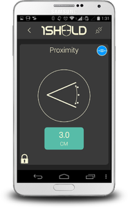

You will find the code below, it is so easy. Actually, the code simply gets the values of the oreinataion sensor from the mobile for the 3 directions (x,y,z) and map then on the servos and use the proximity sensor to open and close the gripper.

After uploading the code on Intel Galileo and installing the mobile applications. Open the mobile application and scan for 1Sheeld via bluetooth and connect to the shield.
Choose the orientation and proximity shields, and then test.
