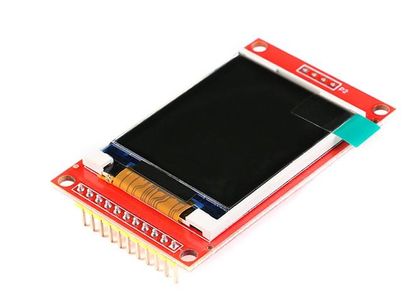

LCD TFT ST7735

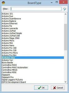

Step 4: Start Visuino, and Select the Arduino UNO Board Type
Start Visuino as shown in the first picture Click on the "Tools" button on the Arduino component (Picture 1) in Visuino When the dialog appears, select "Arduino UNO" as shown on Picture 2

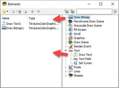

  • Double click on the "Display1" and in the "Elements" window

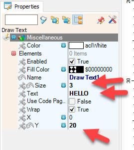

  • Drag "Draw Text" to the left side and in the properties window set "Size to 3, "Text" to HELLO and "Y" to 20

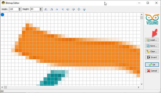

  • Drag "Draw Bitmap" to the left side and in the properties window set "Y" to 50 and select "Bitmap" and click on the 3 dots button
  • In the "Bitmap Editor" click on the "Load" button and load the bitmap file in this case it was Visuino-logo.png
  • Click "Ok" button to Close the "Bitmap Editor" window
  • Close the "Elements" window

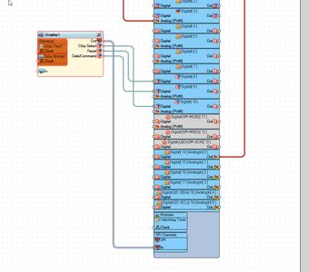

Step 6: In Visuino Connect Components
  • Connect "Display1" component pin [Out] to Arduino pin SPI [In]
  • Connect "Display1" component pin [Chip Select] to Arduino Digital pin[10]
  • Connect "Display1" component pin [Reset] to Arduino Digital pin[8]
  • Connect "Display1" component pin [Data Command] to Arduino Digital pin[9]
  • Connect Arduino Analog pin [0] to Arduino digital pin [3]
