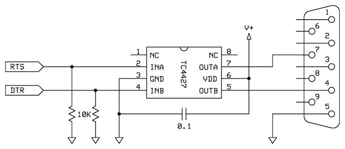

The circuit for controlling the x10 Firecracker is surprisingly very simple.
This is the perfect project for a beginner, as it involves a single chip and a couple "pull down" resistors.
The x10 firecracker isn't actually a "serial communication" device like a modem, but rather accepts data from the micro-controller by reading bit sequences from the DTR/RTS lines. The Propeller can easily send data on these lines using a TC4427 level-shifter.
Jon McPhalen (Parallax forums) came up with this amazing circuit.

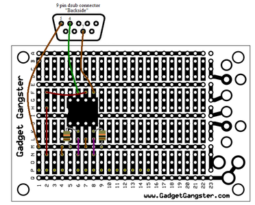

I've used the Gadget Gangster mini-PCB, but any similar PCB will work just as well.
Here are the step-by-step instructions for the attached image.
I've added the use of male pin headers to make the board plug into my Gadget Gangster Propeller Platform, as well as a socket for the TC4427 chip.
- Place 8pin socket at J5-J8
- Red wire from N2 to H2
- Red wire from F2 to F7
- Small jumper wire from N4 to M4
- Small Jumper wire from M7 to L7
- Purple wire from N6 to L6
- Purple wire from N8 to L8
- 10k resistor from M5 to K6
- 10k resistor from M9 to K8
- Wire from M1 to 9pin-5
- Wire from F6 to 9pin-4
- Wire from F8 to 9pin-7
- Solder row of 4 male pins P1-P4
- Solder row of 4 (or more) male pins P6-P9
- Insert TC4427 facing left

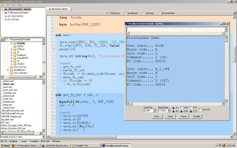

Using the two test programs I provided links to in the first thread, you'll need to adjust the DTR/RTS lines to match your own.
Opening the programs in Propeller Tool, look for the following two lines in the first page of the program and adjust them to:
DTR = 1
RTS = 3
Once you've done that use F10 to send to them to your Propeller and load the Parallax Serial Terminal (Packaged with Propeller Tool.) Jon's test program uses typed commands like, a1on, a2on, a1off, a_bright, and so on. Ron's test program is a bit more interactive, containing both an automated demo as well as step-by-step command ability.

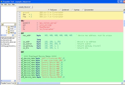

Once you've downloaded and extracted the webserver code, adjust the DTR/RTS lines to match your circuit. (Lines 35,36)

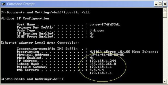

Then adjust the IP address, subnet, gateway, and dns lines to your network. (Lines 48-51)
(You can obtain the subnet, gateway, and dns using "Command Prompt" and "IPCONFIG /ALL" on any Windows station.)
Optionally, you can change the device names by changing the text in the next DAT section. (Lines 56-65)

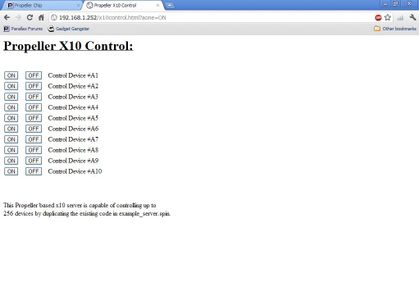

Once you've made the adjustment, connect the circuit to your network and access it by http://THE_IP_ADDRESS/x10control.html from your web browser. You should have the ability to turn on/off any of the 10 devices on x10 "A".
