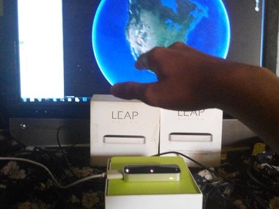

Introduction: Control Your Computer in the Air Like Tony Stark! ( Create Your Own Leap Motion App )
About: Maker. Moonshot thinker. Researcher. Programmer. Quizzer. Teenager!
Hello Everyone,
I'm Geeve George a 15 year old Maker.I love Computer Vision , Android Development and Algorithm Design.I am currently in 11th Grade and also a Research Collaboration Student with the MIT Media Lab India Intiative.
Most of you might have watched the Iron-Man Movies. Tony Stark's inventions are the main attraction in the iron-man series.
My dream is to build the Iron-man suit some day. And the inventions in the Stark Tower are something which I always wish to make.
Most of you might have seen that Tony Stark controls his computer in the air , when I was younger I used to always love the way tony stark simplified the interaction between the physical world and digital world.
And I would try to replicate them in my projects. And now I am happy to make an instructable on how to program an app so that you can control your computer in the air. :)
I would like to extend my special thanks to Intel , Instructables and Adafruit for awarding me the Adafruit Giftcards with which I was able to buy the Leap Motion Controller.

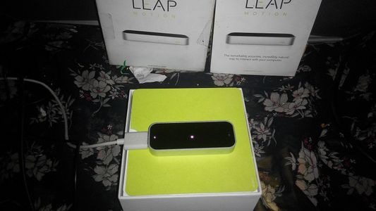

1. Leap Motion Controller ( Buy it here )

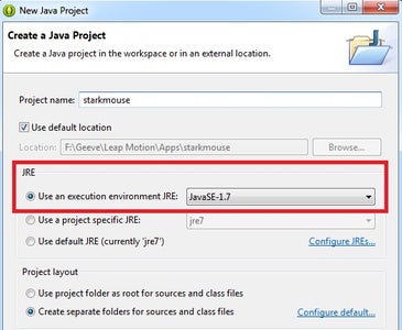

1. Open Eclipse , then click on File > New > Java Project .
2. Give the Project a name , and make sure you set execution runtime environment JRE to Java SE 1.7 as shown in the pictures.

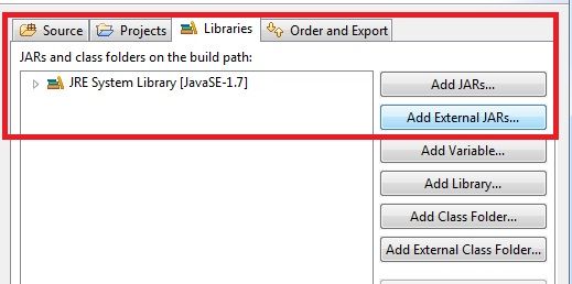

3. Then click on next , the open the Libraries Tab and select "Add External JARs" and navigate to the folder you previously extracted.
4. Then open the LeapSDK folder and go to the libs folder and select the LeapJava.jar file.

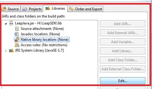

5. Next click on the triangular drop down button beside LeapJava.jar and then click on Native Library Location from the Drop Down Menu , then click on edit as shown in the picture.

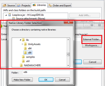

6. Then click on External Folder and navigate to LeapSDK folder > lib > and select x64 or x86 folder based on your Operating System and click OK and then click on finish.

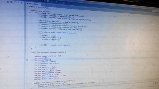

1. First we create a Leap Motion Listener : ( Note : Import the necessary libraries ) , the listened detects when the leap motion controller is connected to the computer.
package starkmouse;
import java.io.IOException;
import java.awt.AWTException;
import java.awt.GraphicsDevice;
import java.awt.GraphicsEnvironment;
import java.awt.MouseInfo;
import java.awt.Point;
import java.awt.Robot;
import java.awt.event.InputEvent;
import java.awt.event.KeyEvent;
import com.leapmotion.leap.*;
import com.leapmotion.leap.Controller.PolicyFlag;
public class leapmoues {
	public static void main(String[] args) throws AWTException {
		Controller controller = new Controller();
		controller.setPolicyFlags(PolicyFlag.POLICY_BACKGROUND_FRAMES);
SampleListener listener = new SampleListener();
		controller.addListener(listener);
		// controller.enableGesture(Gesture.Type.TYPE_SCREEN_TAP);
		// controller.enableGesture(Gesture.Type.TYPE_SWIPE);
		controller.enableGesture(Gesture.Type.TYPE_CIRCLE);
System.out.println("Press Enter to quit...");
		try {
			System.in.read();
		} catch (IOException e) {
			e.printStackTrace();
		controller.removeListener(listener);
}</p><p>class SampleListener extends Listener {

Step 5: Complete Code!
<p>package starkmouse;</p><p>import java.io.IOException;
import java.awt.Robot;</p><p>import java.awt.event.InputEvent;
import java.awt.event.KeyEvent;</p><p>import com.leapmotion.leap.*;
import com.leapmotion.leap.Controller.PolicyFlag;</p><p>public class leapmoues {
		controller.setPolicyFlags(PolicyFlag.POLICY_BACKGROUND_FRAMES);</p><p>		SampleListener listener = new SampleListener();
		controller.enableGesture(Gesture.Type.TYPE_CIRCLE);</p><p>		System.out.println("Press Enter to quit...");
		try {
			System.in.read();
		}</p><p>		controller.removeListener(listener);
}</p><p>class SampleListener extends Listener {</p><p>	boolean readyForControl = false;
	int screenWidth;
	int screenHeight;
	boolean iBoxGet = false;
	InteractionBox iBox = null;
	Robot robot;
	boolean isMoving = false;
	boolean unGrip = false;
	boolean wasFacingDown = true;
	boolean wasInTabState = false;
	boolean wasTabbing = false;
	boolean justCircleGestured = false;
	boolean isResizing = false;</p><p>	public void onConnect(Controller controller) {
		System.out.println("Connected");
		GraphicsDevice gd = GraphicsEnvironment.getLocalGraphicsEnvironment()
				.getDefaultScreenDevice();
		screenWidth = gd.getDisplayMode().getWidth();
		screenHeight = gd.getDisplayMode().getHeight();
		System.out.println("Screen Resolution: X: " + screenWidth + ", H: "
				+ screenHeight);
		readyForControl = true;
		try {
			robot = new Robot();
			robot.setAutoDelay(5);
		} catch (AWTException e) {
			// TODO Auto-generated catch block
	}</p><p>	public void onFrame(Controller controller) {
		Frame frame = controller.frame(); // The latest frame
		// Frame previous = controller.frame(1); //The previous frame
		// System.out.println("Frame available");
		if (!iBoxGet) {
			iBox = frame.interactionBox();
			iBoxGet = true;
			System.out.println("Interaction box set!");
		// Pointable furthestFront = frame.pointables().frontmost();
		Hand rightHand = frame.hands().rightmost();
		Vector palmV = rightHand.palmVelocity();
		// System.out.println("Velocity: X: " + palmV.getX() + ", Y: " +
		// palmV.getY()
		// + ", Z: " + palmV.getZ());
		Vector palmN = rightHand.palmNormal();
		// System.out.println("Normal: X: " + palmN.getX() + ", Y: "
		// + palmN.getY() + ", Z: " + palmN.getZ());</p><p>		Point mouseLoc = MouseInfo.getPointerInfo().getLocation();
		int currentMouseX = mouseLoc.x;
		int currentMouseY = mouseLoc.y;</p><p>		if (readyForControl && rightHand.confidence() > .15) {
			if (!isMoving && !wasInTabState && frame.hands().count() > 1) {
				Hand leftHand = frame.hands().leftmost();
				if (leftHand.pinchStrength() > .8
						&& rightHand.pinchStrength() > .8) {
					if (!isResizing) {
						System.out.println("Resizing...");
						robot.keyPress(KeyEvent.VK_ALT);
						robot.keyPress(KeyEvent.VK_SPACE);
						robot.keyRelease(KeyEvent.VK_SPACE);
						robot.keyRelease(KeyEvent.VK_ALT);
						robot.keyPress(KeyEvent.VK_S);
						robot.keyRelease(KeyEvent.VK_S);
						robot.keyPress(KeyEvent.VK_DOWN);
						robot.keyPress(KeyEvent.VK_RIGHT);
						robot.keyRelease(KeyEvent.VK_DOWN);
						robot.keyRelease(KeyEvent.VK_RIGHT);
						isResizing = true;
				}else{
					if(isResizing){
						System.out.println("Resizing complete!");
						robot.mousePress(InputEvent.BUTTON1_MASK);
						robot.mouseRelease(InputEvent.BUTTON1_MASK);
						isResizing = false;
			// System.out.println("Confidence: " + rightHand.confidence());
			if (rightHand.grabStrength() > .99 && !wasInTabState && !isResizing) {
				if (!isMoving && palmN.getY() < .8) {
					robot.keyPress(KeyEvent.VK_R);
					robot.keyRelease(KeyEvent.VK_R);</p><p>					robot.keyPress(KeyEvent.VK_ALT);
					robot.keyPress(KeyEvent.VK_M);
					robot.keyRelease(KeyEvent.VK_M);
					isMoving = true;
				}</p><p>				// System.out.println(rightHand.grabStrength());
			} else {
				// System.out.println("Not grabbing");
				if (isMoving) {</p><p>					robot.mousePress(InputEvent.BUTTON1_MASK);
					isMoving = false;</p><p>					if (palmN.getX() != 0 && palmN.getY() != 0
							&& palmN.getZ() != 0) {
						if (palmN.getY() < -.1 && palmN.getZ() > -.8) {
							if (currentMouseY <= 8) {
								robot.keyPress(KeyEvent.VK_WINDOWS);
								robot.keyPress(KeyEvent.VK_UP);
								robot.keyRelease(KeyEvent.VK_WINDOWS);
								robot.keyRelease(KeyEvent.VK_UP);
							} else {
								if (screenWidth - currentMouseX <= 12) {
								} else if (currentMouseX <= 12) {
									robot.keyPress(KeyEvent.VK_LEFT);
									robot.keyRelease(KeyEvent.VK_LEFT);
						} else {
									+ ", Y: " + palmN.getY() + ", Z: "
									+ palmN.getZ());
							robot.keyPress(KeyEvent.VK_N);
							robot.keyRelease(KeyEvent.VK_N);
			}</p><p>			if (!isMoving && !isResizing) {
				if (palmN.getY() < -.8 && palmN.getZ() > -.5) {
					wasTabbing = false;
					if (wasInTabState) {
						robot.keyPress(KeyEvent.VK_ENTER);
						robot.keyRelease(KeyEvent.VK_ENTER);
				} else if (palmN.getY() >= .8 && wasFacingDown
						&& !wasInTabState) {
					System.out.println("Alt tabbing");
					wasFacingDown = false;
					wasInTabState = true;</p><p>					wasTabbing = false;
					robot.keyPress(KeyEvent.VK_CONTROL);
					robot.keyPress(KeyEvent.VK_TAB);
					robot.delay(100);
					robot.keyRelease(KeyEvent.VK_TAB);
					robot.keyRelease(KeyEvent.VK_CONTROL);
					try {
						Runtime.getRuntime().exec(
								"cmd /c start " + "C:\\WindowSwitcher.lnk");
					robot.delay(300);
				} else if (wasInTabState && !wasFacingDown && !wasTabbing
						&& palmN.getY() < .45) {</p><p>					wasTabbing = true;
				} else if (wasInTabState && !wasFacingDown && wasTabbing
						&& palmN.getY() > .75) {
					wasTabbing = false;
			}</p><p>			/*
			 * if (!isMoving && !wasInTabState) { /* if(palmN.getZ() <= -.7 &&
			 * rightHand.grabStrength() < .1){
			 * System.out.println("Palm vertical velocity: " +
			 * rightHand.palmVelocity().getY()); //float resultVerticalV =
			 * Math.round(Math.abs(rightHand.palmVelocity().getY()) - 1);
			 * //if(resultVerticalV > 0){ robot.mouseWheel((int)
			 * Math.round(((rightHand.palmVelocity().getY()) / 500))); //}
			 * }else{
			 */</p><p>			if (!isMoving && !wasInTabState && frame.gestures().count() > 0
					&& frame.hands().count() == 1 && !isResizing) {
				CircleGesture circleGesture = new CircleGesture(frame
						.gestures().get(0));
				// System.out.println("Pinch strength: " +
				// rightHand.pinchStrength());
				if (circleGesture.durationSeconds() > .5 && !justCircleGestured
					System.out.println("Closed a window!");
					robot.keyPress(KeyEvent.VK_F4);
					robot.keyRelease(KeyEvent.VK_F4);
					justCircleGestured = true;
			} else {
			}</p><p>			float xSpeed = (palmV.getX() / 6);
			float ySpeed = (palmV.getY() / 6);
			// System.out.println("xSpeed: " + xSpeed + ", ySpeed: " + ySpeed);
			robot.mouseMove((int) (currentMouseX + xSpeed),
					(int) (currentMouseY - ySpeed));</p><p>			// }
}</p>
