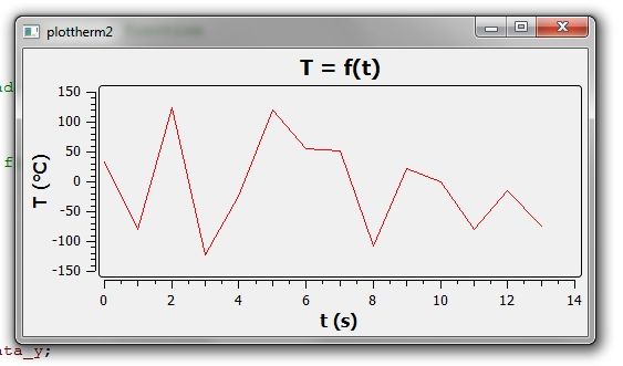

In this instructable, we have see how to use Qt to control your arduino.
I know that this example is very minimalist, but I'm sure that you will be able to start bigger project.
Next time I will show you how to plot graph on Qt, so you could also monitor temperature, pressure...
