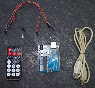

Step 1: Things Needed :
Arduino (I'm using uno but any should do).
USB cable for the arduino.
IR receive diode.
Universal IR remote.
jumper cables for the IR decoder.

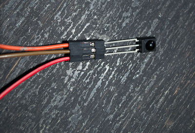

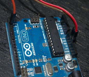

Step 2: Connect the IR Decoder to the Arduino
connect the IR decoder pins to the arduino as :
left -> pin 2
middle -> GND
right -> +5V

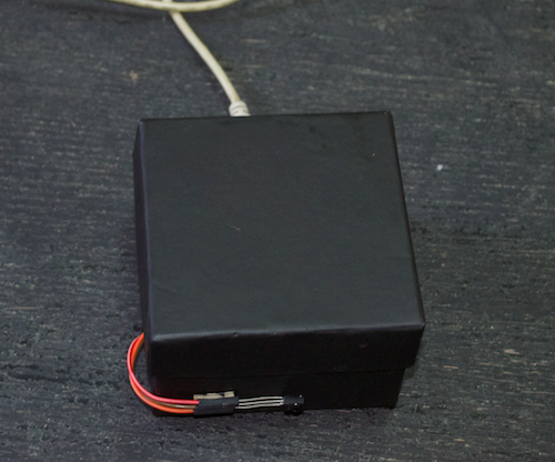

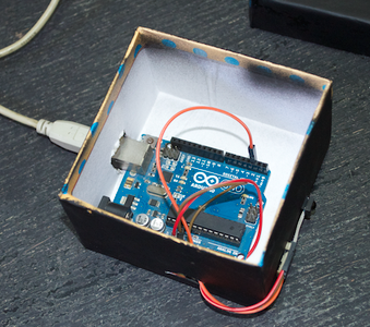

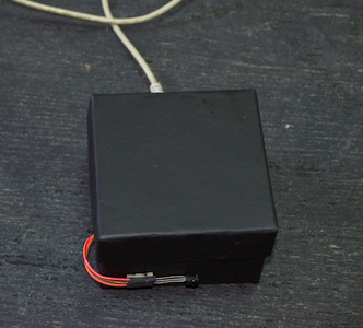

Step 3: Find a Nice Looking Enclosure (optional)
I used a cardboard box just to make the project good looking without the showing the arduino and the wires.

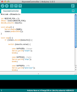

Step 6: Arduino Code
use the previously read commands in the switch of this program to send commands to the app.

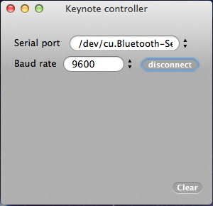

Step 7: Connect the App to the Arduino
open the app and choose the serial port which the arduino is connected to then set the baud rate to 9600 (for the previous sketch) then click connect.
