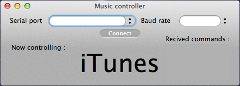

Step 4: Download the App
go to my website, head to apps page and download the music controller app.
this app lets you control your music players with the serial port , for example if the app received "playpause" from the serial port it's connected to it will toggle play/pause in the music player
the app supports the following commands:
"activate"-> opens or activates the selected player
"playpause" -> play/pause
"next" -> next track
"previous"-> previous track
"increasevolume"-> increase volume in selected player
"decreasevolume"-> decrease volume in selected player
"switch"-> switch player control from iTunes to Vox
"quitplayer"-> quit the currently selected player
"quit"-> quit app

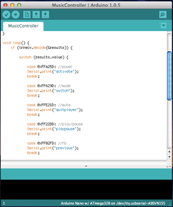

Step 6: Arduino Code
use the previously read commands in the switch of this program to send commands to the app.
Step 7: Connect the App to the Arduino
open the app and choose the serial port which the arduino is connected to then set the baud rate to 9600 (for the previous sketch) then click connect.
