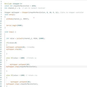

Step 1: Code
The code is simple, it only uses 5 pins on the arduino board. Library "Stepper.h" is used.
Pin Number 3 is responsible for reading data from the Rc transmitter. Pins 8,9,10,11 control the operation of stepper motors.
#include <Stepper.h>
const int stepsPerRevolution = 2038;
int channel_2 = 3;  // pin to connect receiver
Stepper myStepper = Stepper(stepsPerRevolution, 8, 10, 9, 11); //pins to stepper controler
void setup()
  pinMode(channel_2, INPUT);
  Serial.begin(9600);
void loop() {
  int value = pulseIn(channel_2, HIGH, 25000);
  if(value==0)
  myStepper.setSpeed(0); //standby
  myStepper.step(0);
  else if(value > 1800)  //rotate cw
      myStepper.setSpeed(10);
  myStepper.step(stepsPerRevolution);
  else if(value < 1200) // rotate ccw
  myStepper.step(-stepsPerRevolution);

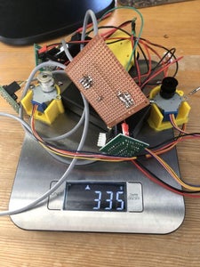

Step 2: Circuit
Connect the VIN and gnd pins to 5v power. We can use a higher voltage, but you will need a 5v voltage regulator as stepper motors is rated for 5v. Pin 3 connect with ch2 (signal) Pin 8 - in1 Pin9 - in2 Pin 10-in3 Pin 11-in4  To organize everything, it is worth using a universal PCB. I used a 5x7cm tile. I connected everything using connectors and gold pins.
