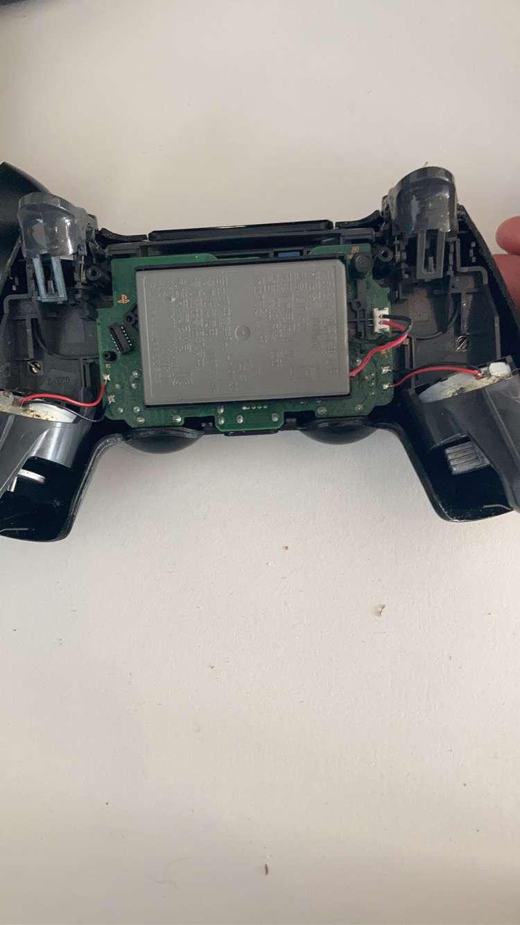

1. When the controller is open you will see a White cable connected to the case and the board. Disconnect the cable from the board slowly. (Note :It must be slow because the copper that makes contact with the board can break very easily.)
2.When the cable is disconnected, Unplug the battery from the board and unscrew the screw that holds the plastic battery holder. take out the plastic battery holder and leave it to the side .Now unplug the cable located above the board .This blue tag is the touchpad cable. (Note: Make sure you push the cable above out of the hole in the chassis because it can casually get caught by other plastic parts.)

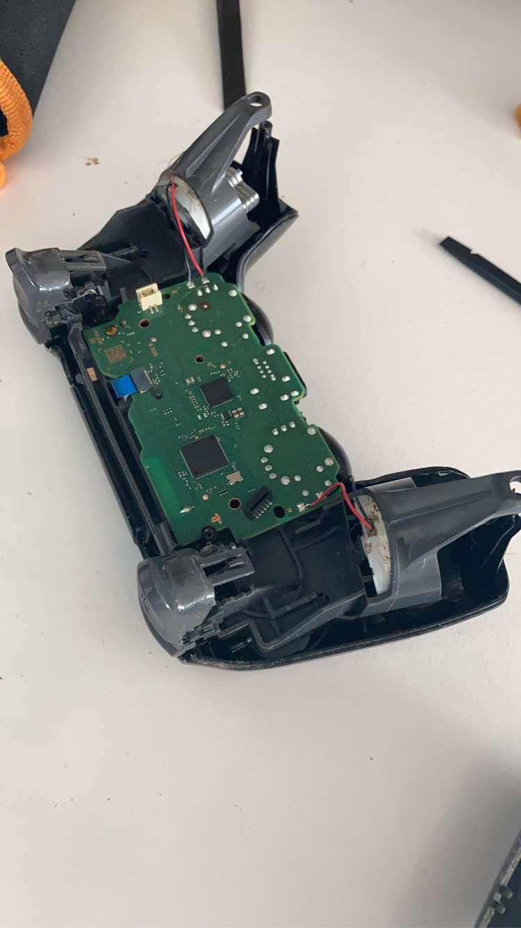

  1. When all electronics are unplugged gently pull the board out of position and the chassis at the same time.(Note: when pulling the chassis loose buttons will fall out depending on which model you have. most common buttons that fall out is the share and options buttons and the main touch pad.)
  2. when the chassis is removed unhook the touchpad and leave it to the side.
