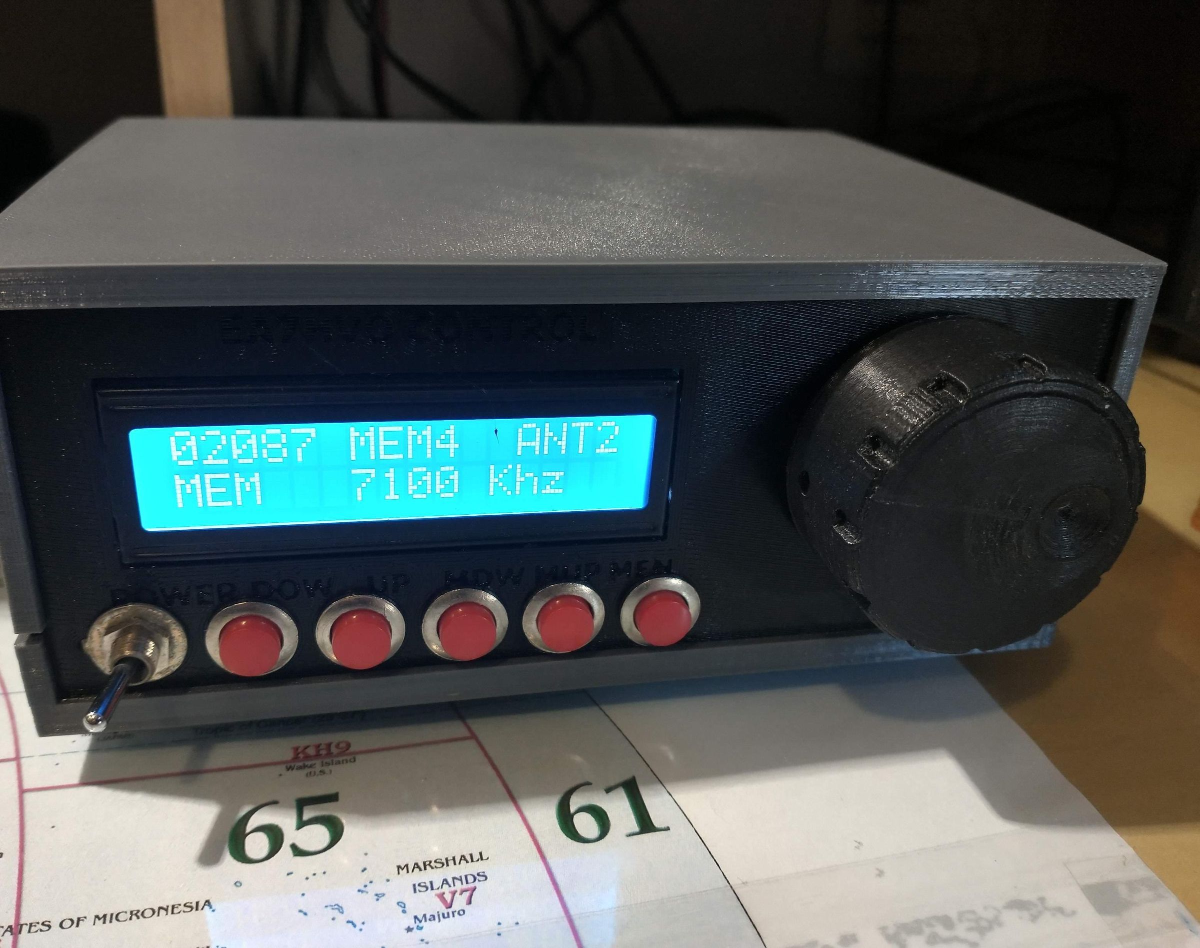

Step 1: Overall View
In this photo you can see the CNC shield over the arduino uno, the optical rotary encoder , the I2C 16x2 display and the five push buttons at the bottom.Finally we have the two endstop switch.

Step 15: 3D PRINTED CASE
I have made a 3d printed case to install properly all the components.
You need to buy some aditional parts that fit properly in the case :
Screws m3 x 8mm (flat countersunk head) for the feet and arduino
Step 16: ASSEMBLY
Fix the arduino in the base.
Intall the rj45 sockets and wire them to the dupont conector like in picture nº 3
Probably you will neeed some glue to fix the rj 45 to the rear panel.
There are some holes to pass the wires just in case you don't have the rj45 sockets.
The feet lock the case .
You can add some silicone feet to add some grip .
