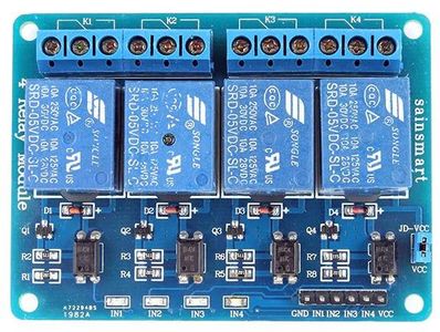

  • 4 Channel Arduino Relay

  • Connect Arduino pin [GND] to Relay pin[GND]
  • Connect Arduino pin [VCC] to Relay pin[VCC]
  • Connect Arduino digital pin [2] to Relay pin[IN1]
  • Connect Arduino digital pin [3] to Relay pin[IN2]
  • Connect Arduino digital pin [4] to Relay pin[IN3]
  • Connect Arduino digital pin [5] to Relay pin[IN4]

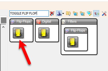

Step 3: Start Visuino, and Select the Arduino UNO Board Type
Start Visuino as shown in the first picture Click on the "Tools" button on the Arduino component (Picture 1) in Visuino When the dialog appears, select "Arduino UNO" as shown on Picture 2

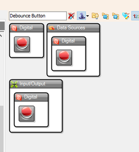

  • Add 4X "Debounce Button" component
  • Add 4X "Toggle Flip Flop" component, this component is used to Switch the relay On or Off, by default the "Initial Value" is False, you can change it to True, this will set the Relay On at the start

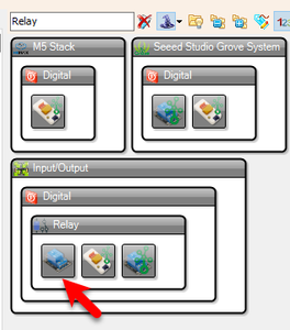

  • Add 4X "Relay" component, this component is not necessary because it does not have any function, it is used only for easier visualization of the project

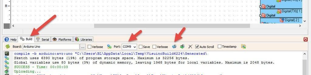

In Visuino, at the bottom click on the "Build" Tab, make sure the correct port is selected, then click on the "Compile/Build and Upload" button.
