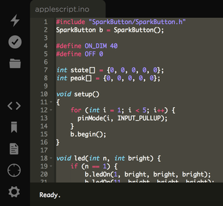

Step 2: Triggering Events From Spark Core
The buttons on the "internet button" Spark Core shield are hooked up to D1-D4. You can upload this sketch from GitHub via the spark.io website, and then flash it to your board with the lightning bolt (top left). This will have the Spark Core monitor the buttons and emit events when one or all buttons are released after being depressed. (Pressing just 2 or 3 buttons and then releasing will not trigger an event, this is deliberate.)
To see the sketch is working you should see the light nearest the depressed button light up when you press it.
