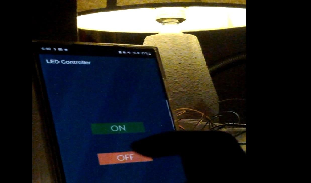

Step 5: Controlling the DC Motor
In order to control DC motor from internet, using any web browser open enter the ip address from step 1 in the address bar and a page will be opened as shown in the attached Fig above. In order to rotate motor clockwise press Move Right button once. Pressing Stop button will bring motor to stop. Similarly, pressing Move Left button will rotate the motor anticlockwise. Refer to attached video to see a demonstration of project.For basic Arduino web control tutorial using ESP8266, refer to second attached video.
Note :Two additional buttons also appear: Light ON and Light OFF, ignore these buttons.
