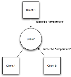

In this protocol, every client need to connect to any address of the broker which is known as the topic to be subscribed in MQTT. In single broker there can be multiple topics and clients can also subscribe to multiple topics of the same broker.
First lets see this process in block diagram which will be easy for you to understand.Second Image shows the block diagram.So basically here we have one broker and 3 clients subscribed to the topic “temperature”.

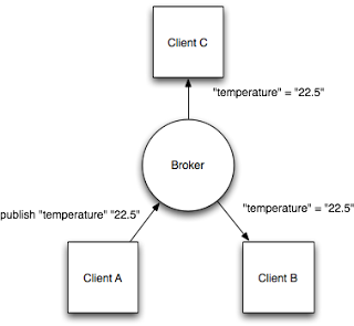

So as soon as any of the client(Temperature Sensor) publishes or updates the value of Temperature to the broker, than all the clients(Smart Phone) subscribed to that topic will receive the value of temperature updated. This is shown in Third image.That’s it. We can do a lot with this simple protocol. We can even subscribe to the topics of any other person if we know the username and password of the broker.

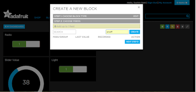

Now we will start with making a new button on the dashboard. For that click on the 2nd button i.e."Create a New block". It will show this window(Image 6).
There are number of blocks to be added in this window like toggle button, push button, slider etc. In our project we will be using the first block i.e. toggle button. Click on create button and you will get following options(Image 7).
Than you have to provide feed name which should be unique because this feed name is nothing but the topic which clients will be subscribing. I have given name of the feed as on off. Than click the create button. And click on the choose button front of your feed name. Than click on the next step( Image 8).
