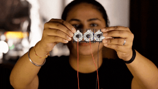

  3. 3 × BioAmp Snap Cables
  4. 3 × Gel Electrodes

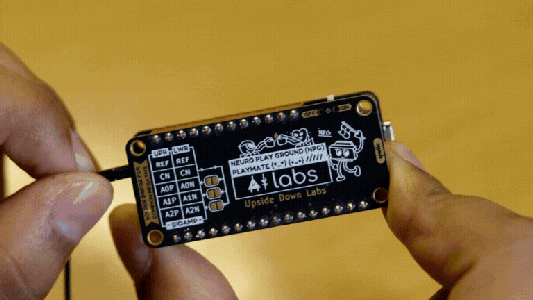

What is Neuro PlayGround Lite?
Neuro PlayGround (NPG) Lite is a compact Adafruit Feather form factor, 3-channel wireless biopotential signal amplifier designed for EMG, ECG, EOG, and EEG recording.
It offers Wi-Fi, Bluetooth, Zigbee, and Thread connectivity, along with patient protection, LEDs (User LED, charging LED, 6 addressable RGB LEDs), buttons (Reset and user button), LiPo battery charging, and USB-C with ESD protection. Its lightweight and user-friendly design makes it perfect for research, education, and wearable applications.

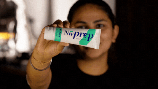

Step 1: Skin Preparation
Before detecting the EOG signals, it's essential to prepare your skin to ensure you get accurate EOG data.
Start by applying Nuprep Skin Preparation Gel to the areas where you'll place the electrodes. This gel gently exfoliates the top layer of the skin, removing dead cells and oils that can interfere with signal transmission.
After rubbing the gel in a circular motion for a few seconds, clean the area using an alcohol swab or wet wipe. This step ensures that your skin is ready for the best possible electrode contact—think of it as polishing the lens before taking a photo!
What is Nuprep Gel?
Nuprep is a mildly abrasive, highly conductive gel that improves electrode contact by reducing skin impedance. It's safe, effective, and causes minimal skin irritation.
Step 2: Connecting BioAmp Snap Cables
Once your skin is prepared, it’s time to connect BioAmp Snap Cables.
Connect 3 BioAmp Snap Cables to
  1. Positive of Channel 1 (A0P)
  2. Negative of Channel 1 (A0N)
  3. Refernece (REF)

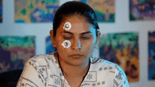

Step 3: Electrode Placement
Correct electrode placement is a crucial step when recording EOG (Electrooculography) signals. The goal is to detect your eye blinks, so you will be placing the electrodes in the position mentioned below:
  1. Negative (A0N) goes above the eye.
  2. Positive (A0P) goes below the same eye.
  3. Reference (REF) goes on a bony area. So bony part behind the earlobe is a perfect spot for this.

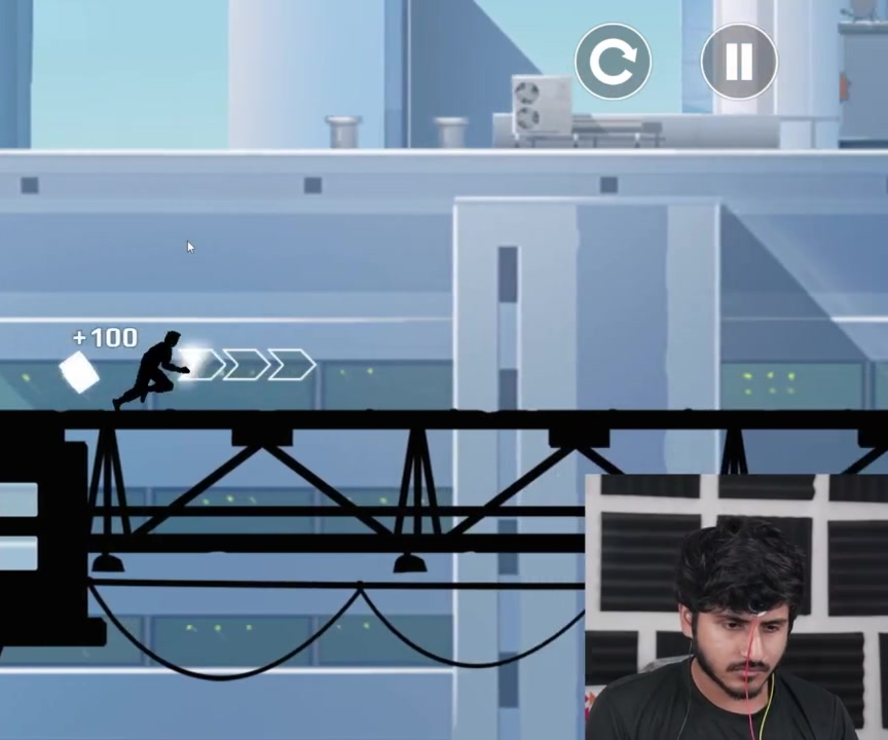

Step 7: Play Chrome Dino Game
This project maps your eye blinks to trigger the Spacebar which is perfect to play the Chrome Dino Game!
Controls & Gameplay:
  1. Connect/Start: Click on connect. Once connected, the button changes to Start, and clicking on it will begin detecting eye blinks.
  2. Eye Icon: When an eye blink is detected it changes color to confirm the blink detection.
  3. Quit: Click on it to exit the application.
Now open Google Chrome and click on this link to launch the Chrome Dino game: https://chromedino.com/
The Chrome Dino is now blink-controlled!
