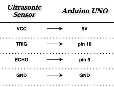

𝐔π₯𝐭𝐫𝐚𝐬𝐨𝐧𝐒𝐜 π’πžπ§π¬π¨π«
  • Positive and negative pins connected to 5v and GND respectively.
  • 'trig' and 'echo' pins connected to Digital pins.

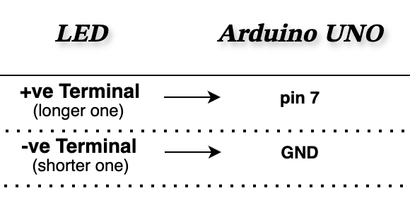

𝐋𝐄𝐃
  • Negative pin connected to GND.
  • Positive pin connected to digital pin (via resistor, if needed)

Connect the parts using jumper wires.
Here is the circuit in TinkerCAD:
Controlling LED blink speed with Ultrasonic
