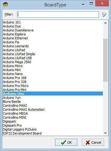

Step 2: Start Visuino and Select Arduino UNO Board Type
To start programming the Arduino you will need to install the Arduino IDE from here: https://www.arduino.cc/.
Please note that there are some serious bugs in Arduino IDE 1.6.6. Make sure you install version 1.6.7 or higher or this tutorial will not work! If you have not already followed the steps in this tutorial to set up the Arduino IDE to program the Arduino UNO! Visuino: https://www.visuino.eu also needs to be installed. Launch Visuino and click the "Tools" button on the Arduino component in Visuino (Figure 1) as shown in the first picture When the dialog box appears, select "Arduino UNO"

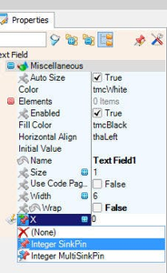

Select " LedController1 " and in the properties window select " Pixel Groups " and click on the 3 dots. In the "PixelGroups" window drag "2D Graphics" from the right to the left Select the left "2D Graphics1" and in the properties window set: - "Height" to 8 - "Mirror Horizontal" to true - "Orientation" up - "Reverse Horizontal" to True - "Reverse Vertical" to False - "Width" to 32 - Select the "Elements" window drag "Fill Screen" to the left, expand "Text" and drag "Text Field" to the left. Select "Text Field 1" and in the properties window set "Wrap" to false, select "X" and click on the "Pin" icon and select "Integer SinkPin" << see image Close all windows
