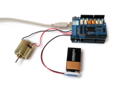

Step 1: Theory Part
Moving things take a lot of energy. Motors typically require more current than what Arduino can provide. To start moving when it has a heavy load, the motor will draw as much current as it can. The Arduino boards can only prove 40 milliamps (mA) from its digital pins, which is much less than what most motors require to work.
Thus to make this motor work, we will be drawing power from a external power source, ie from a 9V battery. Input of current from the 9V battery will be guarded by the Arduino.
Transistors are components that allow you to control high current and high voltage power sources from the low current output of the Arduino. There are many different kinds, but they work on the same principle. You can think of transistors as digital switches. When you provide voltage to one of the transistor's pins, called the gate, it closes the circuit between the other two pins, called the source and drain. This way, you can turn higher current/voltage motor on and off with your Arduino.
Polarized 1N4007 Diode is a special component used to make the current flow only in one direction. If a motor is manually rotated backwards, it generates electricity, which can damage the circuit. Thus using this diode, we can solve the problem.
Step 2: The Circuit and Programming Part
Make the circuit look exactly the same as given in the image above. Make sure that the metal plate of transistor is towards the right. Also make sure that the end of Diode 1N4007 with a strip is towards the right.
Do not attempt this experiment if you are unclear with the circuit. Leave a comment for clarification. Incorrect circuit can damage your board.
