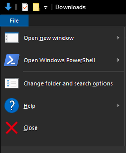

1. Save the file as [filename].py, example: “tutorial.py” (without the quotes). o If your text editor saves with .txt extension by default click on the “Save as type”, change the option to “All Files” or “.py” in place of “.txt”. 2. In windows, navigate to where you have saved your file. Click on the file and you should see “Open Windows PowerShell” or “Open Command Prompt” (shown in Figure 3). Click on either of the options.
