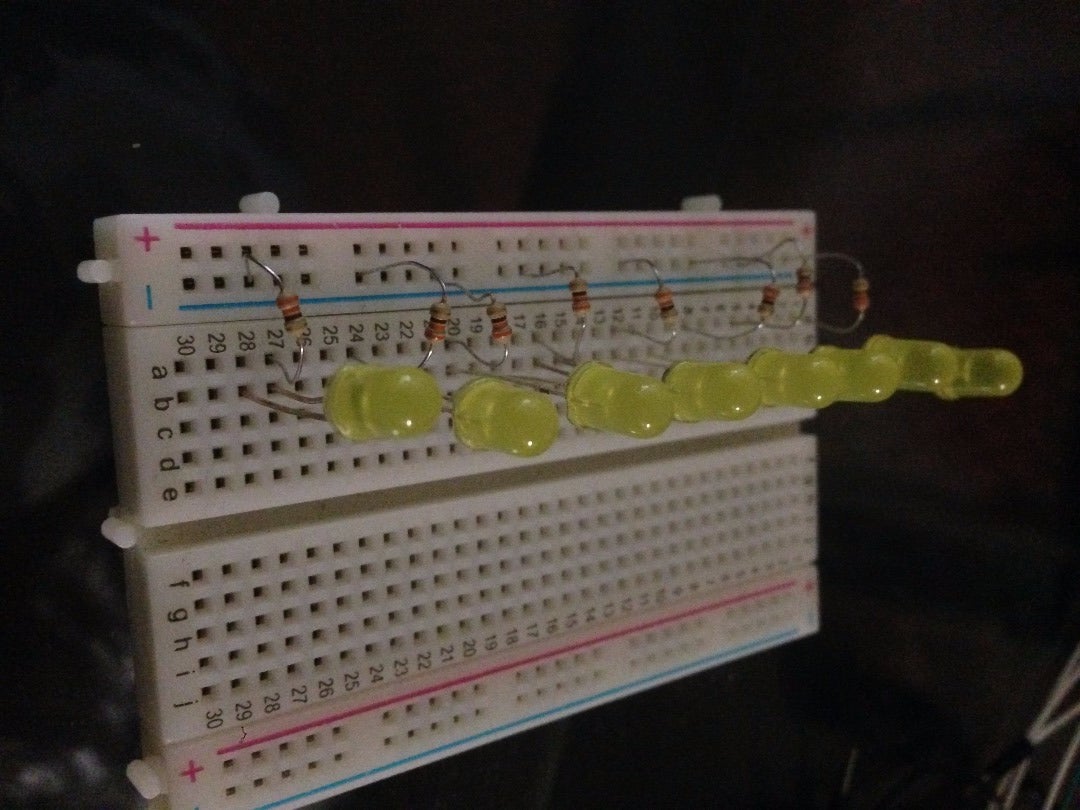

The components requires for this project involvve; Eight LEDs, Ten jumper wires, a breadboard, Eight 330ohm resistors, an Arduino micro controller and its connecting cable and finally a working computer. And have the drawn circuit close by for direct reference while building.
Step 2: Connecting the Resistors.
Have the breadboard laying on a flat surface to enable solid connections.The breadboard has signs for positive (as in power) and negative (as in ground) connections. Place the resistors on the breadboard, with one leg in the negative column(ground) of the breadboard and the other leg in a different hole located somewhere else on the breadboard.
Step 3: Connecting the LEDs.
For each LED, connect the negative side (shorter leg) of the LED into the same row of a resistor. Not on the same row as the negative column but on the same row as the other leg of the resistor. Then connect the positive side (longer leg) of the LED into other holes in a different column and row on the breadboard
Step 4: Connecting the LEDs to the Arduino Microcontroller.
For each LED connect the positive side(longer leg) to digital pins on the Arduino using jumper wires. Connect one end of the wire to the same row of the positive side of the LED and connect the other side of the wire to digital pins. There are a total of eight LEDs on the breadboard therefore connect wires from eight positive LED sides to digital pins two through nine (in no particular order).

As earlier explained, power needs to be supplied to the breadboard and the ground connection also needs to be made. Place one end of a jumper cables into the hole on the top column marked with the positive sign on the breadboard and then connect the other end to the pin labeled 5V on the Arduino. And then connect one side of another jumper wire to the top hole of the negative column on the breadboard and the other end of the wire to a pin labelled GND (ground) on the Arduino.
