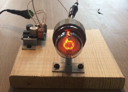

IN-1 tube needs around 180V to work. The boost converter NCH6100HV can provide just that. It boost the 12V input voltage to up to 180V output voltage
DISCLAIMER!!!! Working with high voltage can be dangerous. Please take extreme caution if you plan on using Nixie tubes in your projects.
Here is the diagram of how boost converter should be connected to the nixie tube to power the tube and light up a single digit.
Also you see the photo of the digit 6 being lit by connecting nixie tube anode to 180V and connecting ground to cathode/pin 6 corresponding to digit 6. If you want to lit a different digit you need to connect GND to other pin.
If you connect GND to multiple cathodes, multiple digits would lit.

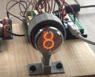

In the image you see an example where we want to display digit 2. We pass binary representation of 2 : 0 0 1 0 to four input pins and that grounds second leg of the microchip. If that leg is connected to second pin of nixie tube the digit 2 would glow.

And finally in the main loop we have a fourloop executed 10 times. For each iteration it reads the corresponding row from digits table representing the digit and sending bits of that digit to ABCD pins of arduino.
That results in groubdin corresponding pin of the microchip which in turn sends low signal to the selected cathode of the nixietube causing the digit linked to that cathode to glow.
