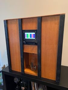

Do you want to modernize your home bar experience while still maintaining a classy and stylish bar feel? Here is a versatile project that can be easily modified to meet your own design. The goal of this project is to bring together a raspberry pi, touch screen, diaphragm pumps, and various electrical components to automatically pour six different drinks. Each of the six options can be quickly poured to either 0.5oz, 1oz, 2oz, and a free flow.
This project serves as a great beginners guide to programming graphical user interfaces(GUI) and learning to control mechanical components with digital call outs.

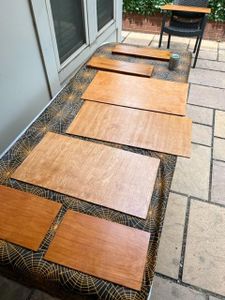

Stain and Varnish Boards.

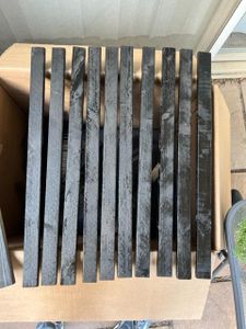

Spray Paint the Planks.

Step 31: Finished Result!!
