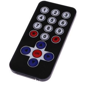

  • IR Remote Sender

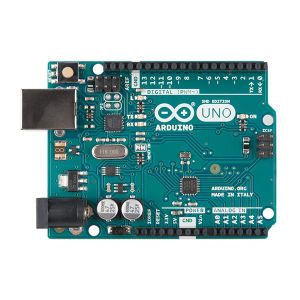

  • Arduino UNO (or any other Arduino or ESP)

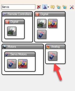

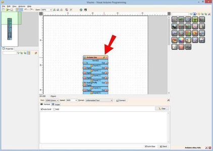

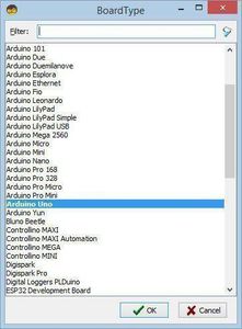

Step 4: Start Visuino, and Select the Arduino UNO Board Type
Start Visuino as shown in the first picture Click on the "Tools" button on the Arduino component (Picture 1) in Visuino When the dialog appears, select "Arduino UNO" as shown on Picture 2

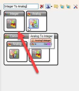

Step 5: In Visuino Add Components
  • Add "Infrared Remote Receiver" component
  • Add "Up/Down Counter" component
  • Add "Integer To Analog" component
  • Add "Servo" component

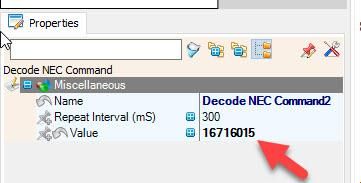

Lets set the commands for the Left & Right button on the Remote, you will need a Code for that, in my case it was 16734885 & 16716015 each Remote might use different code, if you do not have it check out the Next step on how to obtain the code.

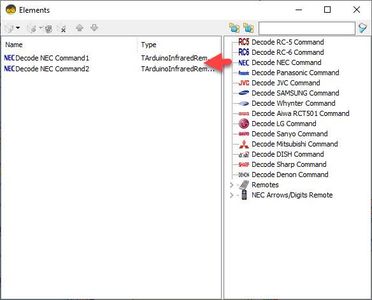

  • Double Click on the "InfraredReceiver1" and in the "Elements" window drag "Decode NEC Command" to the Left side and in the properties set Value to 16734885
  • Drag another "Decode NEC Command" to the Left side and in the properties set Value to 16716015
  • Close the "Elements" window

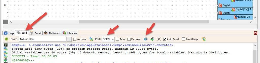

Step 9: Generate, Compile, and Upload the Arduino Code
In Visuino, at the bottom click on the "Build" Tab, make sure the correct port is selected, then click on the "Compile/Build and Upload" button.
