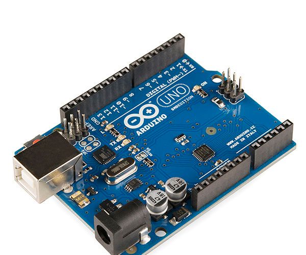

1. Arduino board (I used arduino UNO)
2. Servo motor ( I used a HD-3001HB servo motor)
3. Male to Male wires

Step 2: Step 2: Assembling the Servo Motor to the Arduino
In a servo motor, there will be three connections provided. In my case, my servo motor consists of connection coloured dark brown,red and orange. After several rounds of internet search, I found that:
1. Dark brown connects to the GROUND
2.Red connects to 5V
3.Orange connects to arduino UNO pin 9
I have attached a JPEG image of the sketch for further clarification(I made the sketch using fritzing by the way). However in the sketch the connections are colored Black, Red, and Yellow:
1. Black connects to the GROUND
2. Red to 5V
3. Yellow to arduino UNO pin 9
