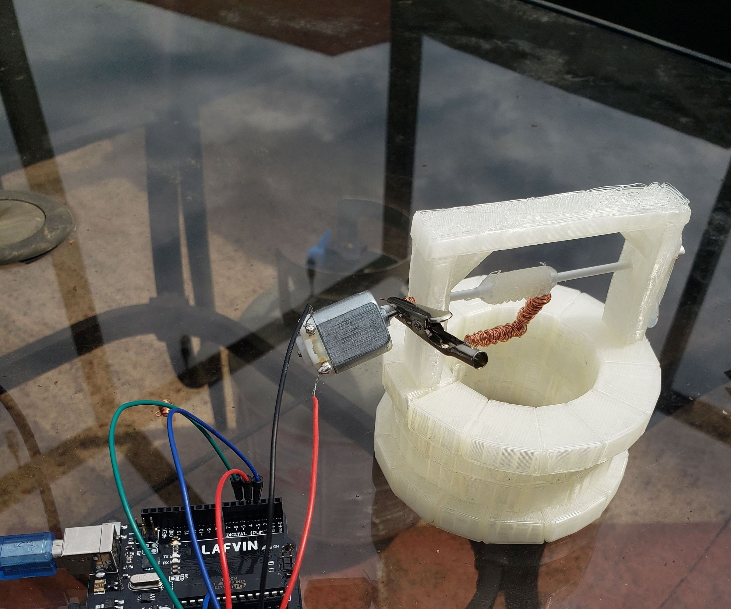

FYI - I am in the process of building a sort of rickety prototype as in the picture of the Earth hole. Those parts are optional:
Aluminum, steel, epoxy, shovel
1x Arduino Uno R3 (I got mine from Amazon)
2x Servo Motors (I am using a Micro Servo)
1x Joystick Module
9V Battery
Wires & Breadboard
