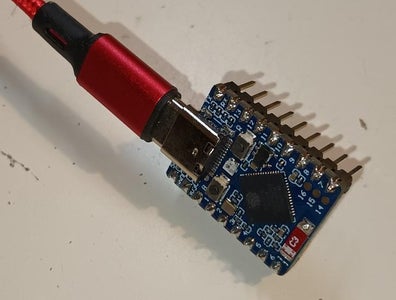

This project uses an ESP32 (tested with both a Standard-ESP32[NodeMCU] , and also an ESP32S3 [Waveshare ESP32S3-zero]) to directly turn a Shelly Relay on and off (ie. without needing any internet connection or registration).

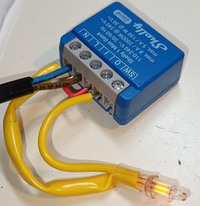

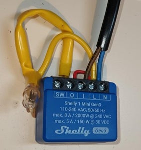

The attached Arduino-Code (file "ESP32_Shelly_BLE_Controller_v28July25.ino") demonstrates turning the Relay on and off, which I was testing using the small Neon-Bulb (which included a resistor to enable it to work at 240Vac) – as shown in the above photos.
