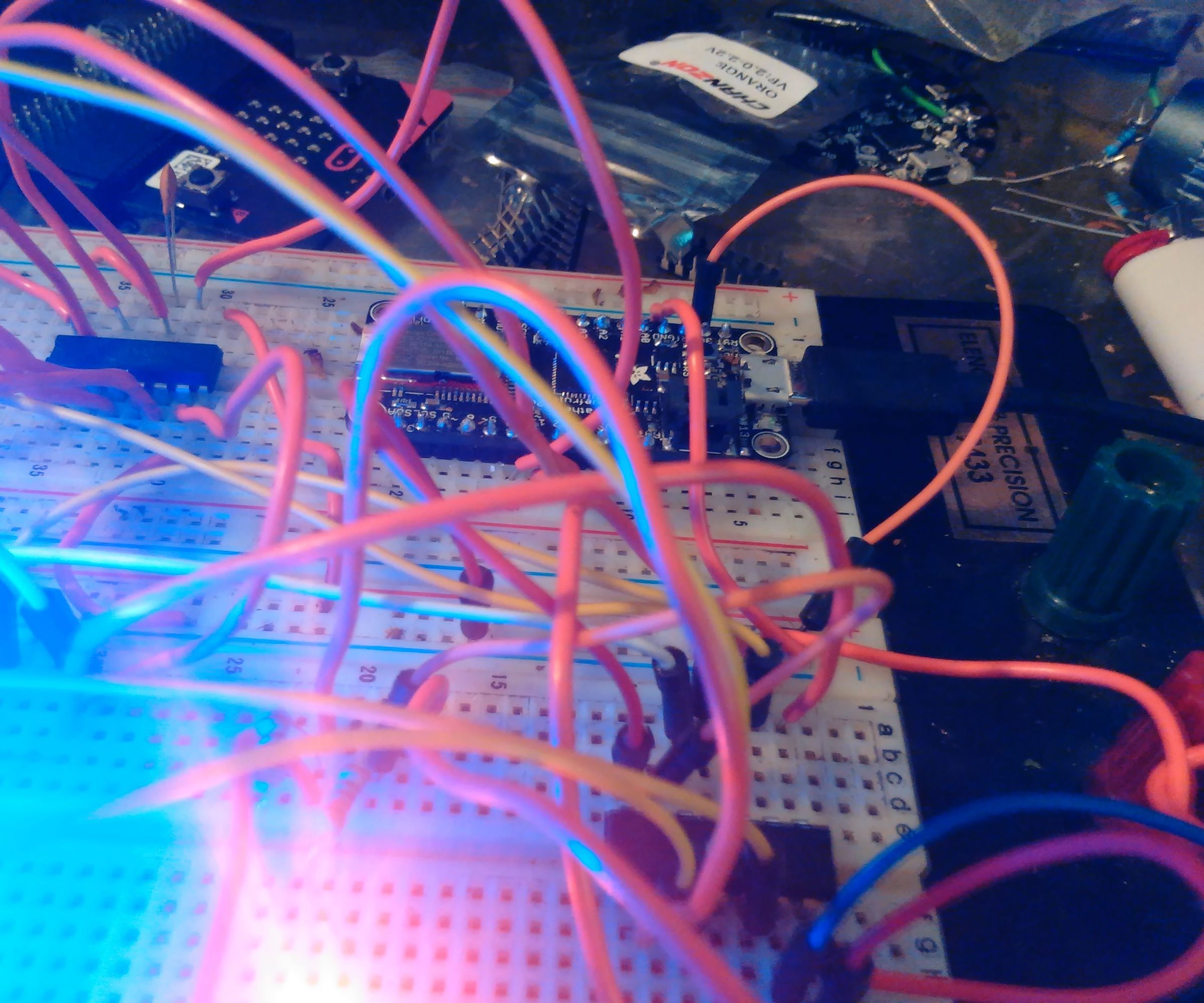

Ok so for the wiring I have a picture above of what I have here.
Connect Tx on the Huzzah to Pin 2 on the arduino.
Connect Rx on the Huzzah to Pin 3 on the arduino.
I created another serial socket on pins 2 and 3 on the arduino to free up the default Serial Console.
Connect the Pin V+ and En to 5v from the arduino. - The adafruit Huzzah has a built in voltage 3.3v regulator so plugging these pins in like this might not work with all ESP8266 modules. You may need to wire in your own voltage regulator. I recommend using the Huzzah if you just want to get the thing working easily.
Connect the GND to the GND of the arduino
On pins 12,11,9,8 on the arduino wire in your LEDs I used low powered LED's here because the ones that draw too much current may draw too much power for the sake of keeping this experiment simple.
Than on A0 analog Pin 0 on the arduino I have plugged in the output line of my Turpitity tester. However, you can plug in the output of basically any sensor that will give you an analog reading.
Thats all you need to do to wire this up.
