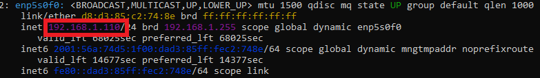

Now that we have installed NGINX, we want to make sure it's running. First in your terminal type
ip -c -h a
And find your local IPv4 address. It will usually either start like 10.X.X.X or 192.168.X.X. Then you should be able to type "http://<your-ip-address>" where your-ip-address is the address which you found above, in my case 192.168.1.110 and you will land on the default NGINX start page. Now we can replace it with our own web page.
