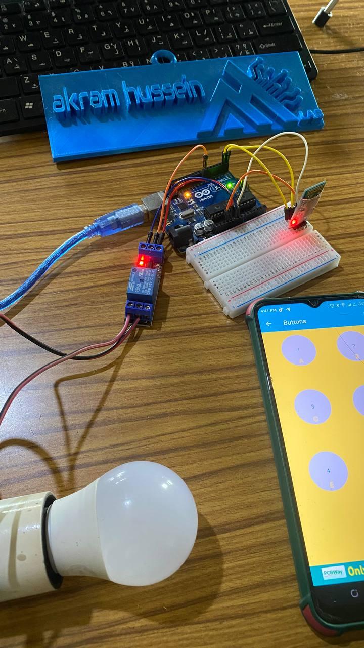

In this project, we'll explore how to control a light bulb using a Bluetooth module (HC-06) and a relay module. With the help of this setup, you'll be able to turn the light bulb on or off wirelessly using your smartphone. This project combines hardware and software components to create a simple yet effective home automation system.

Step 1: Setup Arduino and Relay Module
Relay Module Pins:
  • VCC: Connect this pin to the 5V output of the Arduino or an external power source if required by the relay module.
  • GND: Connect this pin to the GND (ground) pin of the Arduino.
  • IN: This pin is used to control the relay. Connect it to one of the digital pins (in this experiment we have connected it to digital pin 7) on the Arduino.
  • COM, NC, NO: These pins are part of the relay switch. Connect COM (common) to the power source (live wire), NO (normally open) to the appliance (e.g., light bulb), and NC (normally closed) can be left unconnected in this project.

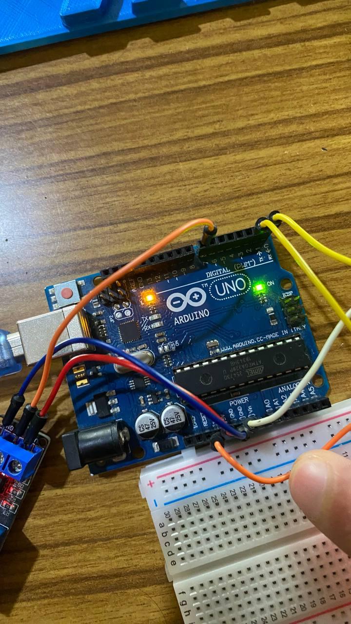

Step 2: Connect Bluetooth Module
HC-06 Bluetooth Module Pins:
  • VCC: Connect this pin to the 5V output of the Arduino.
  • TX: Connect this pin to the RX (receive) pin of the Arduino.
  • RX: Connect this pin to the TX (transmit) pin of the Arduino.

Step 4: Upload the Code
Disconnect RX and TX Wires: Physically remove the RX and TX wires connected to the Arduino from the HC-06 module to prevent interference during the upload process.
Upload Process: Upload the Arduino sketch to the board using the Arduino IDE.
Reconnect RX and TX Wires: After the upload is complete, reconnect the RX and TX wires to the appropriate pins on the Arduino.
Step 5: Control the Light Bulb
Pair Bluetooth with Smartphone:
  • Enable Bluetooth in the settings of your smartphone.
  • Search for available devices and pair with the HC-06 module when it appears in the list.
Bluetooth Terminal App:
  • Download and install a Bluetooth terminal app on your smartphone.
  • Open the app and connect to the paired HC-06 module.
Sending Commands: Send predefined commands (e.g., '1' for turning on the light bulb, '2' for turning it off) via the terminal app to control the relay and, consequently, the light bulb.
