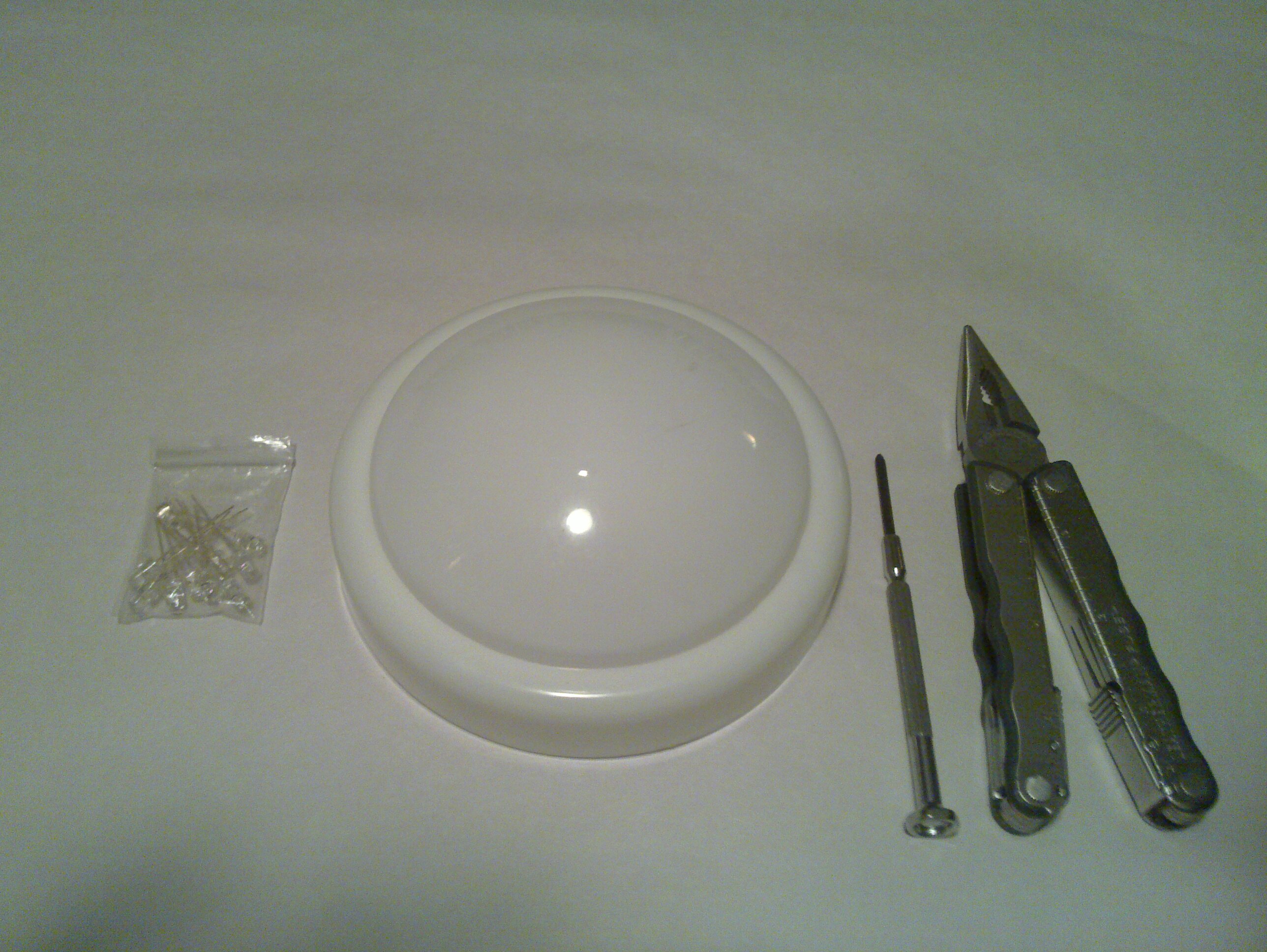

Introduction: Controlling a SaikoLED Myki (or Arduino Leonardo) With a Simple Button Box -- Using the ICSP Header
Welcome! Today we're going to explain how to build a controller with 3 buttons that connects directly to an Arduino Leonardo-compatible board--in this case, the myki light from SaikoLED. More information on the Leonardo is available here and in this Instructable.
You will need the following tools:
- Smallish/Needlenose Pliers (Leatherman worked great!)
- Exacto knife or razor blade or small scissors
- (optional) soldering iron and hair dryer/rework blower
materials:
- A cleaned and dried cylindrical takeout container with lid (or any other container of appropriate size)
- 3 arcade pushbuttons e.g. thesefromsparkfun
- 4 of 12 in / 30cm lengths of ~22 gauge wire
- 1x6-pin ICSP ribbon cable, or 4x female-female .1" pitch jumper cables
- (optional) solder and/or heatshrink tubing
and
- A SaikoLED myki light (available via crowdsupply)
OR
- An Arduino Leonardo setup with red, green, and blue LEDs connected to PWM ports
