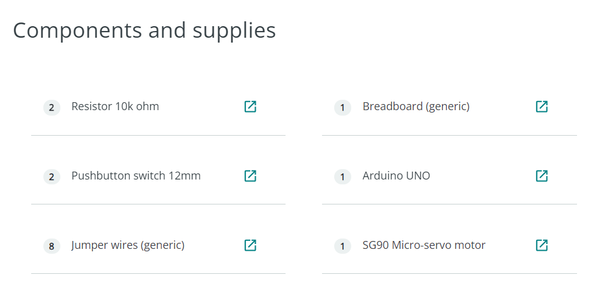

2 / 10k resistors
2 / Pushbuttons 12mm
8 / Jumper Wires
1 / Breadboard
1 / Arduino UNO
1 / SG90 Micro-Servo Motor

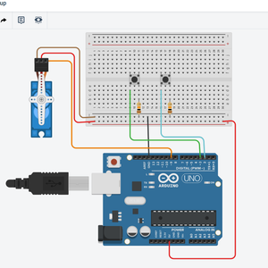

Step 1: Building
  1. Place a wire on D2 of Arduino and D21 of breadboard
  2. Place Terminal 1A of Button on E21 of breadboard
  3. Place a 10k resistor on negative rail 23 and B23 of breadboard
  4. Place a wire on D9 of Arduino and D10 of breadboard
  5. Place Terminal 1A of Button on E10 of breadboard
  6. Place a 10k resistor on negative rail 12 and B12 of breadboard
  7. Place GND micro servo wire on Negative rail 1
  8. Place power micro servo wire on Positive rail 1
  9. Place Signal micro servo wire on D9 of Arduino
  10. Place a wire on 5V on Arduino and Positive rail 30 of breadboard
  11. Place a wire on GND on Arduino and Negative rail 9 of breadboard

Step 3: Testing
Test and troubleshoot if anything is wrong and refer to the images above for help.
