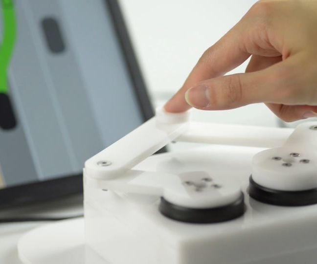

Step 1: First You Have to Make Your Own Platform
Here are some photo's of my process of building my platform.
Building the platform the first time can be difficult. The stewart platform can have many different forms and sizes. I think you should design your own platform to fit your intended purpose. I'm really curious what different kinds of platform you'll make. If you feel like sharing the result, please do!
My intention for this instructable is to provide the software that drives it (see step 2).
NOTE: The software is designed for a platform that uses 6 servo's controlled by an Arduino. Make sure you have a stable serial connection and use an external power for the servo's. If you don't know how to do any of this, google is your friend ;).
