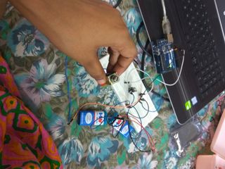

Step 2: Building the Circuit - Power Connections
USB powers the arduino, the batteries power the solenoid. A jumper grounds the two together.
Step 3: Building the Circuit - Transistor Time
 When the transistors labeled side is facing up the legs (from left to right) are B, C, E: Base, Collector, Emitter.
We will connect the output pin of the arduino to the Base leg of the transistor through a 1K resistor.  The Collector leg of the transistor will be connected to the ground leg of the device we are driving (our solenoid).  The Emitter leg is connected to the ground channel of our circuit.
Step 4: Building the Circuit - Connecting the Solenoid
The "ground" leg of the solenoid is connected to the collector leg of the transistor.  The "power" goes to the high voltage power channel (from our batteries).  I put "ground" and "power" in quotation marks because none of the solenoids I've ever used have been polarized so it doesn't matter which lead is connected to ground and which goes to power.
The diode connects the power channel to the solenoid-ground-leg/transistor-collector-leg, preventing the kickback voltage from damaging the circuit.  The diode is polarized and should be oriented with white/sliver stripe on the power channel side of the connection.
I'm using a pull-type solenoid rated for 12 to 24 volts (got it here), which has plenty of kick.  You'll need some kind of spring to pull the shaft back out after it's been pulled in - I used a small length of insulated wire wrapped around the shaft to create a makeshift spring.  In a different sort of configuration one could use gravity to pull the shaft back out (but you'd need some of stopper to prevent the shaft from falling all the way out).
Step 5: Program Arduino and Enjoy
Now just program the Arduino to drive the appropriate output pins and enjoy.  I've connected the transistor to pin 13 so I can see the built-in LED work in time with the solenoid.  The sketch I've used is a simple modification of the "Blink" sketch where I've reduced the on time to 80 milliseconds, which is more than enough time to pull the solenoid all the way in.
