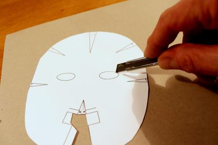

Step 5: The Face
Print the face template and cut out the eye holes and mouth opening. Cut and glue the edges of the face as shown in the picture.
