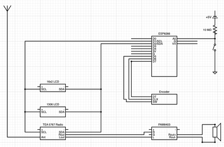

Step 4: Electronics Schematic and Layout
The hardware schematic is simple. The FM radio and LCDs are all connected to the ESP8266 via the SCL/SDA serial communications. The Encoder attaches via 3 digital I/O ports. The TEA5767 output is sent to the PAM amplifier board which is connected to the speaker. The switch that toggles to/from station setting mode is connected to the ESP8266 analog input via a pullup resistor.
Per Step 3, the work is in the layout, and, of course, varies with the donor radio. The use of a terminal block may be handy for keeping the wiring neat.
