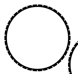

First, I determined the diameter of the inner cylinder of the lampshade. I wanted to map this exactly so that the bulb would not be seen when it was finished.
The diameter of 180 mm is now the basis for further planning in Illustrator.
Here I created a corresponding ring and could thus determine the required number of segments.
The segment length was made dependent on the width of my DIN A3 MDF boards. Here I chose 290 mm length and 7 mm width.
I also wanted to include a curve that spiraled upward around the lampshade.
In Illustrator, I carefully reposition the curve for each segment and gradually move upward
To do this, I had to move the drawn curvature upward accordingly for each segment. (length /(number of segments +1)
Then I connected the lines of each segment with the curvature to achieve an exact fit so that there would be no double cuts during laser cutting.

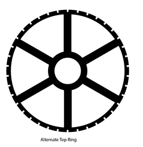

Step 4: Bonus: for Those Who Do Not Have a Matching Lamp
If you don't have an old Ikea lamp, you can use this, my alternative ring instead of the top ring. This is designed for an E27 socket.
Since the inside of the segments are easy to stick with paper or fabric, there is no limit to the color design.
