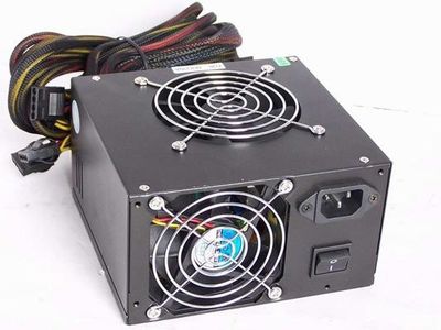

Step 1: !!!PARTS!!!
So as many of you know, you are gonna need a couple of things to build something like what I have.
PARTS LIST:
1 - 300 watt or higher computer power supply

First thing is first. Grab out your power supply. I do not have pictures for this step. Make sure that the psu has been disconnected for 3+ days or grab that resistor and put it between a 5 volt and a ground pin. Cut off all of the connectors coming out of the PSU nearest to the connector. Next, the PSU case comes into two pieces, pull the top from the bottom and it should reveal a box about the size of the case, next grab some snips and cut all of the wires connecting the psu to the 120 volt connector. Leave enough length in both ends of the wire. Save that part for later. Next snip off the power switch and throw out the switch or keep it. We don't need it. Now take the board out of the case. Also grab the fan and take the 120 - 220 volt switch out.

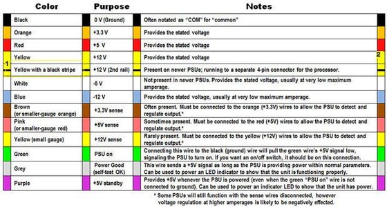

So you have a psu. Now grab the snips, heat shrink and lighter. Read the chart above. You will need 4 5 volt wires, 1 3.3 volt wire, 2 12 volt wires, and all of the ground wires. You will also need the green wire and any wire that is a voltage regulator wire. Every other wire can be snipped and heat shrinked. Grab out some ring terminals, wire, crimpers, iron, solder and strippers. Strip and Tin all of the remaining wires and then put ring terminals on 3 red wires and put 9 black wires into 3 yellow ring terminals. Take one red wire and one black wee and put a 10w 10ohm resistor between them. Also put one of the other terminals on the green wire and another on a black wire. After you have done that put the second type of terminal we have on the rest of the wires. Heat shrink any remaining black wires

From PSU:
3 5 volt wires to 3 red banana jacks (jacks)
3 sets of ground wires to 3 black jacks
1 ground wire to on off switch #1
1 12 volt wire to on off on switch
1 12 volt wire to on off switch #2
1 3 volt wire to on off on switch
