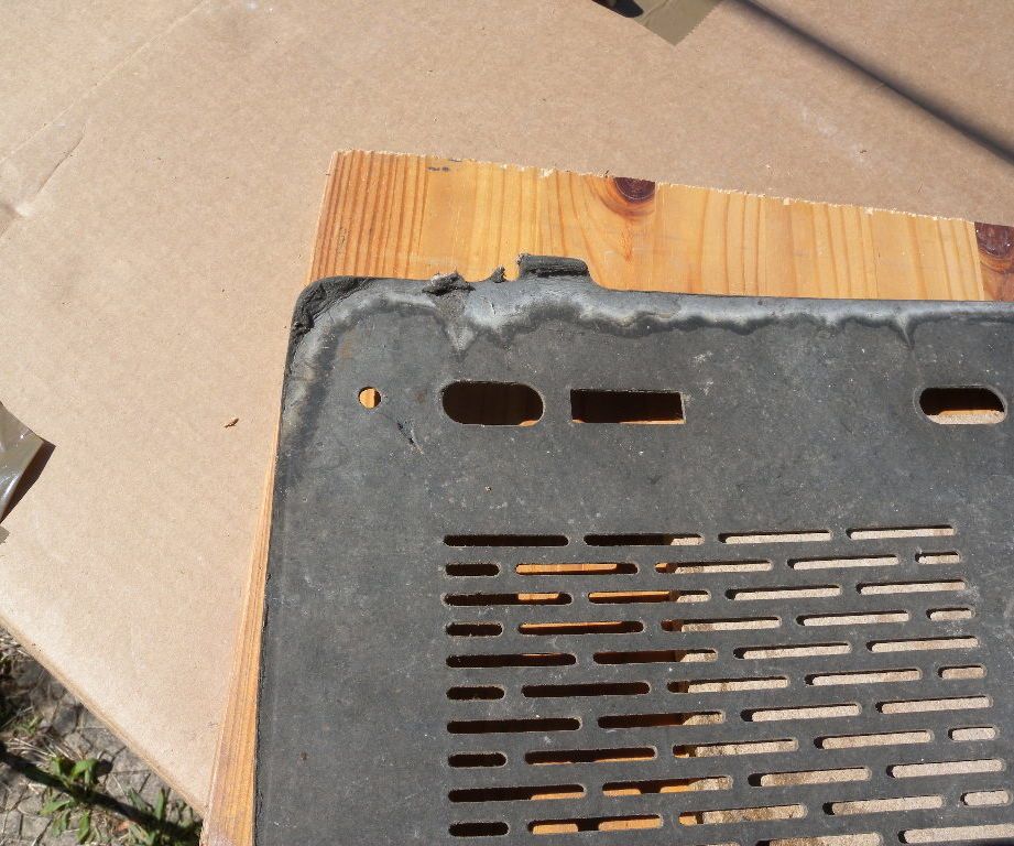

Step 8: Reassemble the Parts
All right, everything should be fitted when all parts are reassembled. Hands should be moving softly.
For keys on the back, use glue to fix it definitively.
I've added a piece of wood to fit the back frame at the right position.
Finally, add a crew to fix the back frame.
